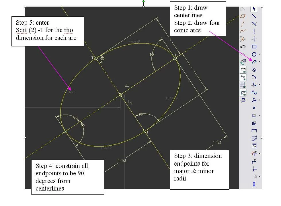

    My understanding is that this is not a mathematically exact ellipse, but you
    can get very very very close by creating 4 conic sections
    The crucial steps are that the conic sections are 90 degrees to the
    centerlines, and entering the relation
    Sqrt(2) - 1
    (which is approximately = .414)
    for the rho value for the arc (that's the dimension that looks like a
    radius)
    Lyle Beidler

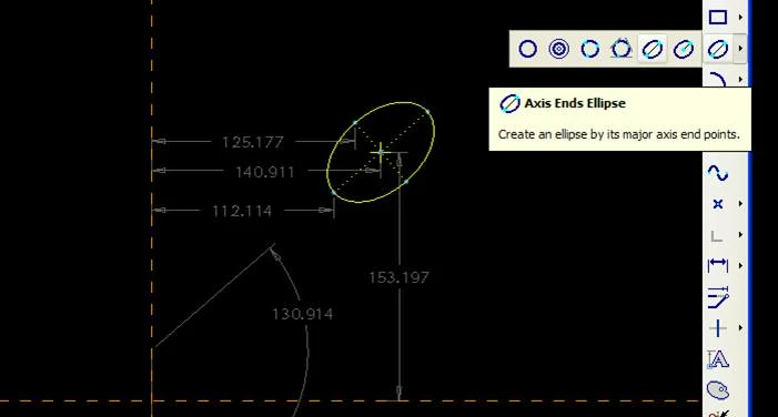

    July 2, 2009
    Can you wait until Wildfire 5.0? 🙂
    Cuz' it's in there as a dedicated icon!
