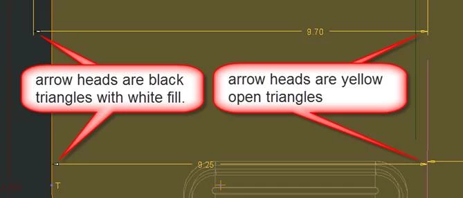

sketcher subtleties
Hello again
Has anyone noticed a different type of arrow head in sketcher? What does it
mean? Check out this image:
Thanks ,
-Nate
    Dec 12, 2013 4:22 PM UTC
    Nathan,
    The white filled triangles represent drag handles in sketcher. You can drag the arrow to change the length of the sketch feature.
    StephenW
    Dec 12, 2013 4:30 PM UTC
    I see the same thing. I created a reference dimension in the sketch and it doesn't do that.
    I thought maybe it was the first pick/second pick but no.
    When I converted a real dimension to reference, the arrows changed to just unfilled yellow
    Dec 12, 2013 4:34 PM UTC
    It looks like a dimension with 1 white arrow is strong.
    A dimension with both arrows white is weak
    And a dimension with no white arrows is reference
    Paul
