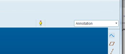

Hi all,
in WF5 is there the manner to select the annotation utilizing the smart filter?
Because I can do this only selecting the filter "annotations", but the filter "smart" should not offer you the possibility of select all?
Is there the possibility of modify some options to do this?
Regards

    Hi Giulio,
    I do not think the smart filter does that. It only allows you to select geometric elements in the order (Model->) Feature-> Geometry for solid and surface elements.

    Nov 25, 2014 6:29 PM UTC
    So, is there no way to do what I've thinked?

    Steven Dunker ha scritto:
    Are you stating if you set the filter to Smart, it won't let you select Annotations?
    With the filter set on "smart", I'm not be able to select the notes.
    Only putting the filter on "annotation" (like in the picture) I can select them.
