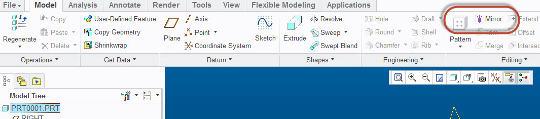

    Hi Ananth,
    I think you would like to mirror the solid features in part, Select part name in Model Tree > Select Mirror in Editing group (By default it will remain inactive and will activate once feature or part is selected) > Select Mirror plane > Ok

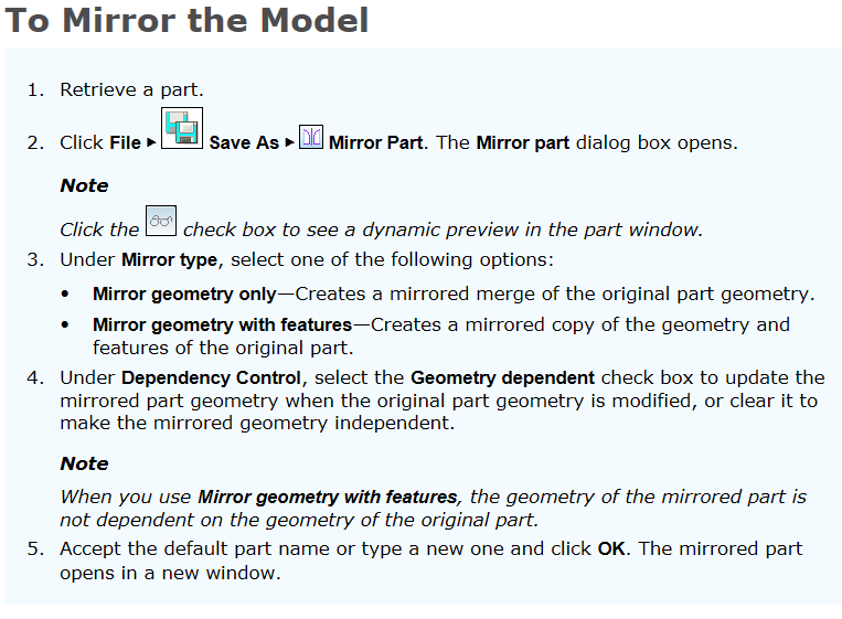

    You can do a "save-as mirror" And you still have the mirror feature.

    It used to be that you'd lick the model name at the top of the model tree, then click the mirror icon. I'm not sure where the mirror icon is in Creo and I'm in WF4 these days. I'm sure a command search for mirror would find it.
    Apr 4, 2014 3:58 PM UTC
    If you look at the file created using save-as, the last feature would be a mirror geometry feature.

    Hi Ananth,
    Apr 4, 2014 4:27 PM UTC
    Unfortunately, this does not suppress or hide the original features. It simply adds the mirrored geometry.
    The Save-As version can be fully independent and uses a Mirrored-Merge feature which cannot be initiated in the active part. This is done by re-creating the full feature set and then doing a single mirror-merge function on the part similar to what you are suggesting. The only downside is that you cannot move the "insert here" bar above this feature in the model tree.
