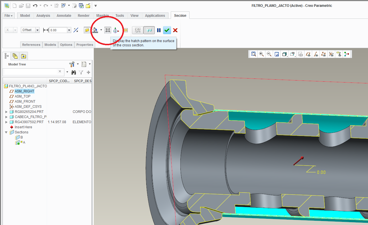

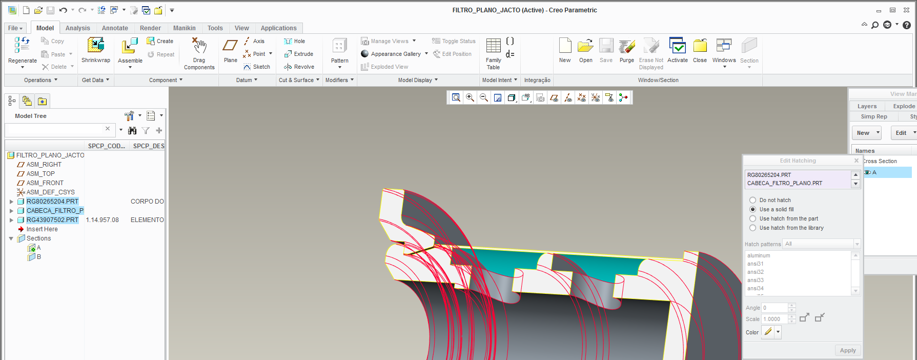

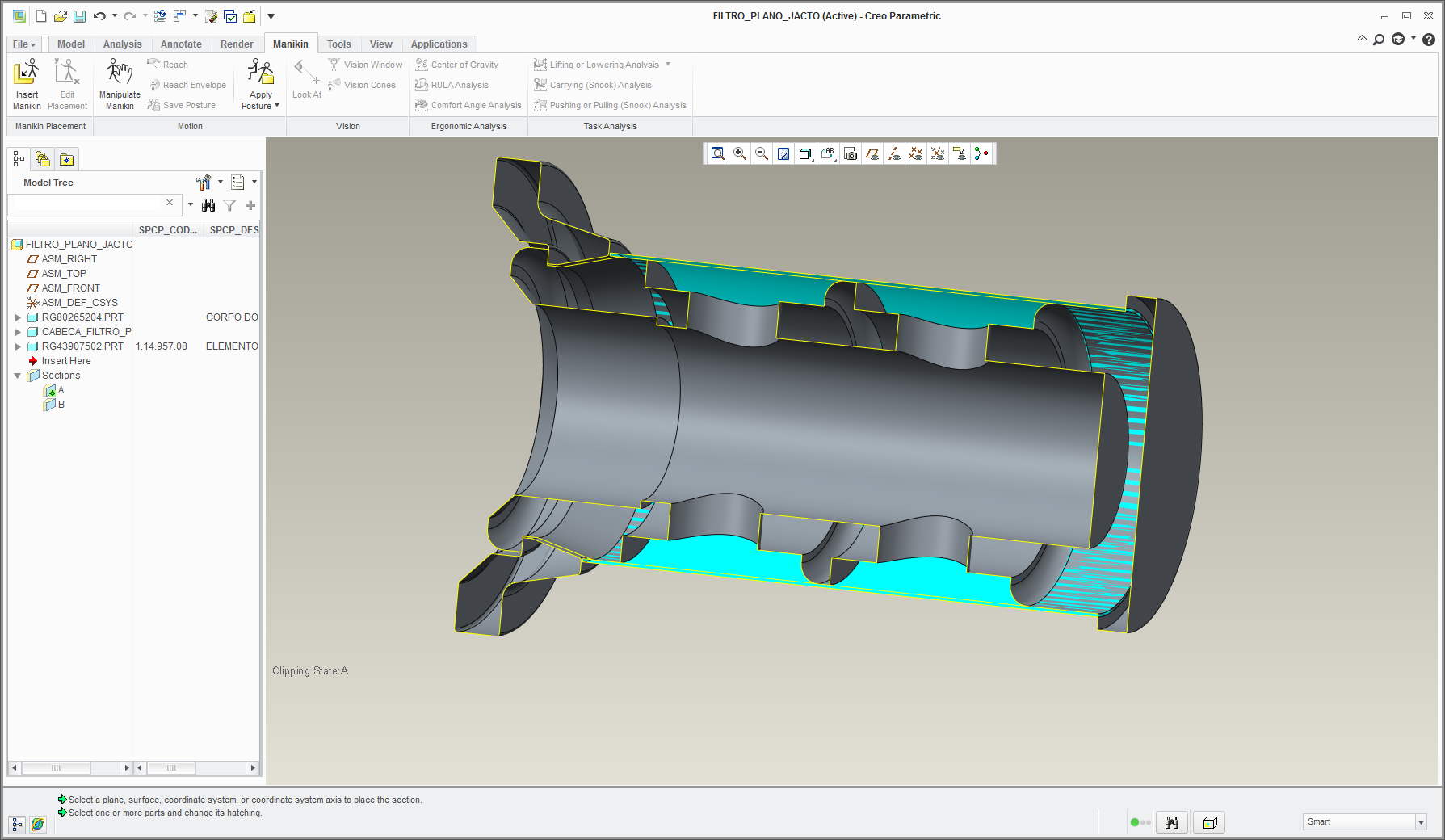

When sectioned, the solid is shown as a shell (both PRT and ASM)
I've found the button to activate the hatch, and how to change the hatch color, in the section edition:
But I need to use this setting in every document I open in Creo 2.0, for PRT and ASM. How do I config this setting, and how do I save?
December 9, 2015
use the following option in config.pro file to see clipped models as solid.
CAPPED_CLIP YES
I think xhatching properties cannot be configured via config.pro file.
MH
