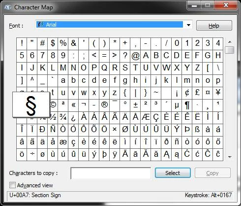

Richard, Is this what you need?
    Have you already tried looking at your symbol library in Pro/E?
    Have you tried the character map?
    The keyboard shortcut is shown in the bottom right corner. This one is hold down Alt and type in 0167
