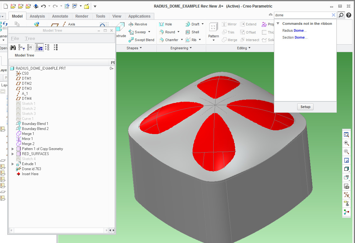

    If you set the option:
    allow_anatomic_features yes
    then you'll be able to use radius dome and section dome to do this kind of thing.
    please examine attached file. it's definitely easier but I'm not sure if you like the results.

    Sep 5, 2014 6:15 PM UTC

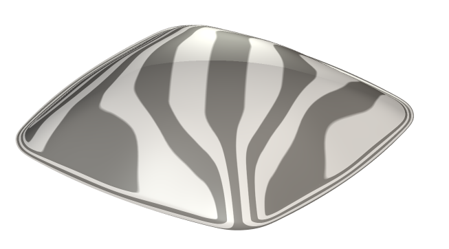

    Here is one attempt. It is quite flexible to get the right "feel". It follows your original edge and fillet.
    I used a arc for the top of the dome, but a spline might give a better ID feel. As you know, these things can really get out of hand if you get enough opinions.
    The key here is the flexibility of the model. It is terminated with a boundary blend between two surfaces with curvature constraints. A somewhat hidden option of managing the curvature is one very powerful control feature as shown in the video. This really should be on by default.
    The reason for the projected sketch from the 1/8th section is just to get an easy to select continuous edge for the sweep. There are other means, of course. More care could be taken on this outer edge for even better curvature control. I just followed the original intent without using true arcs.
    Tweak the "dome" diameter and the plane elevation to get a varied result. Also, the boundary blend's Contraints>"drag handles" will really change the softness of the transition.
    Note: I put the accuracy at absolute .00005 just to make sure there were no wrinkles. You can reset this to relative .0012 without issues. I didn't like the analysis at that course level.
    let me know if you something doesn't make sense.
    Creo 2.0 full version attached.
