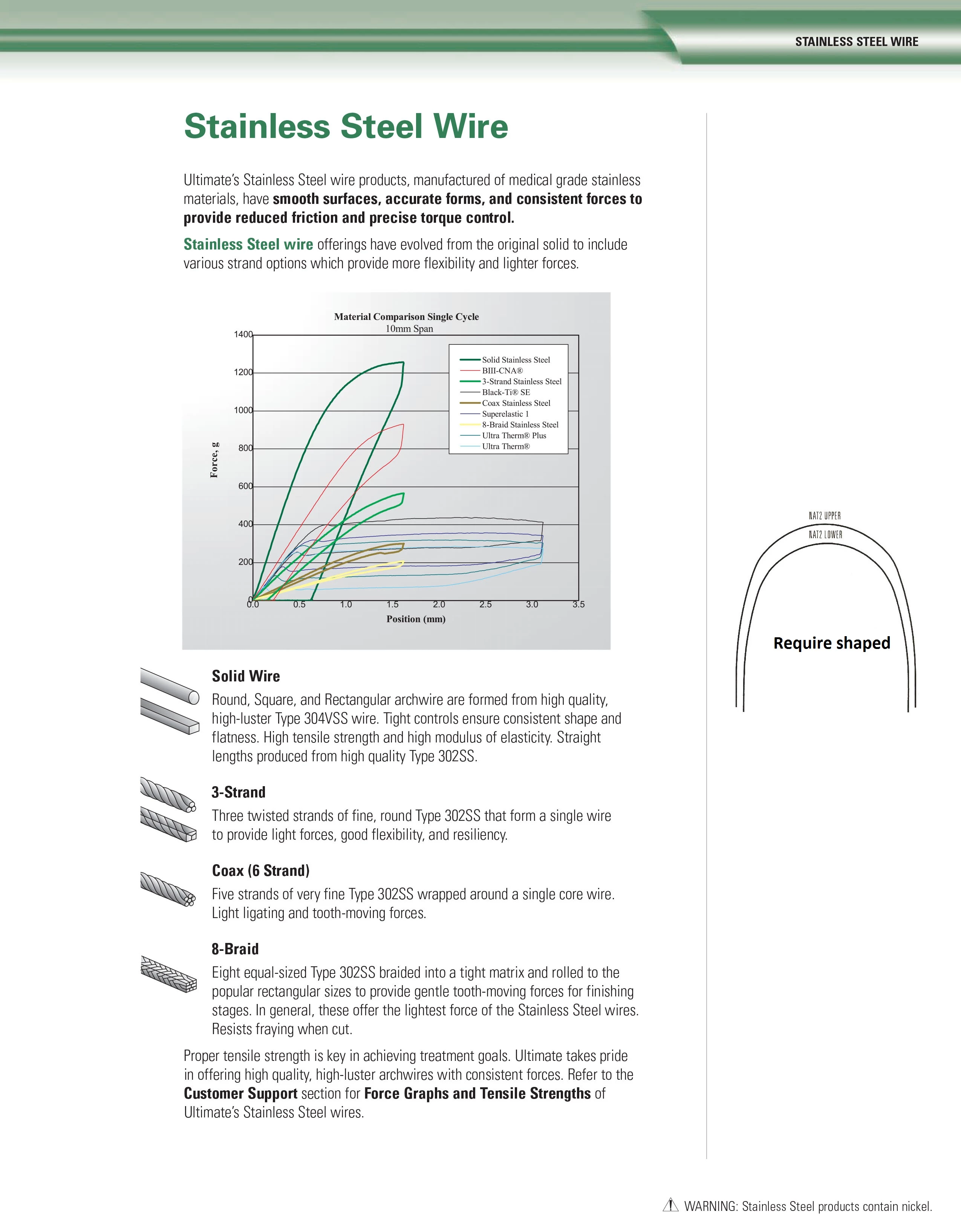

Any one guide me how much force required for mention wires shaped because the SS 304V metrical is spring back. The wires size started .012” to .020” and the other details just like force graphs & tensile strengths as attached.
