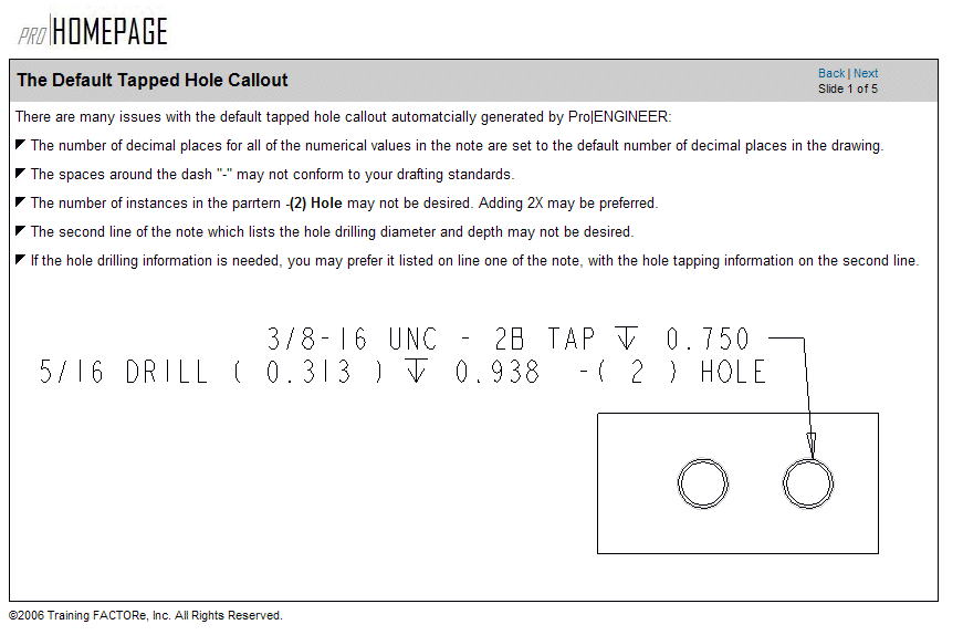

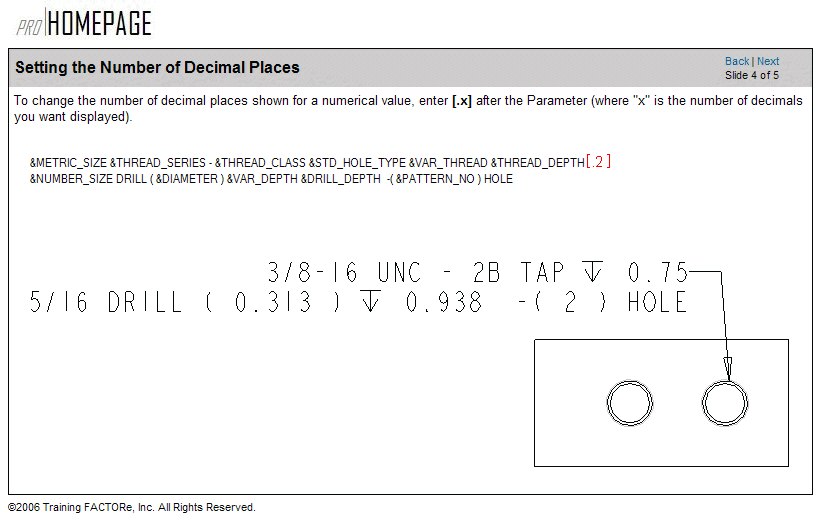

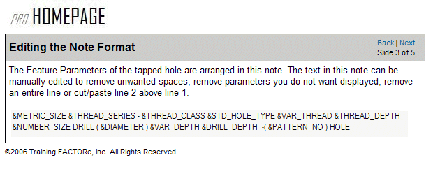

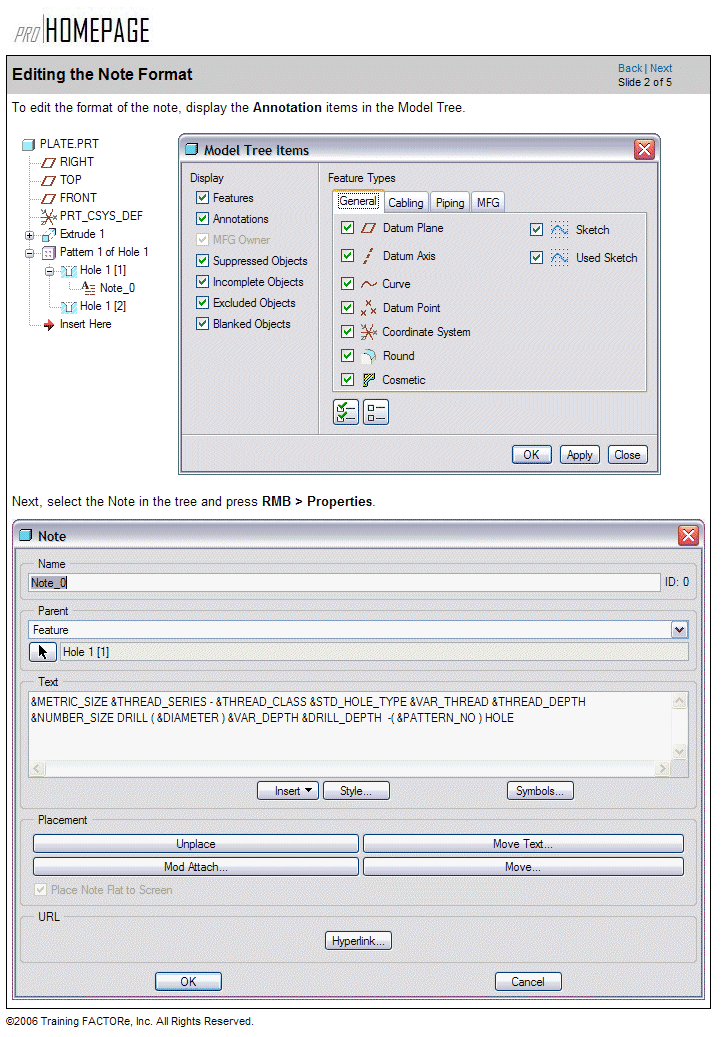

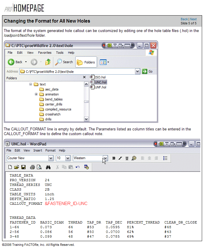

It turns out that using [.0] in the note text, after the value, does the trick. I've included some slide screenshots that detail the process...thanks A. Burke. Thanks to everyone that offered suggestions. Mike Bills
