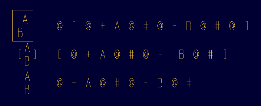

    July 25, 2012
    Now try enclosing super/subscript in a box and note the ofset of the superscript text. Can you say "BUG"!
    @[@+A@#@-B@#@]
    I'll have to report this... but here ya go!
