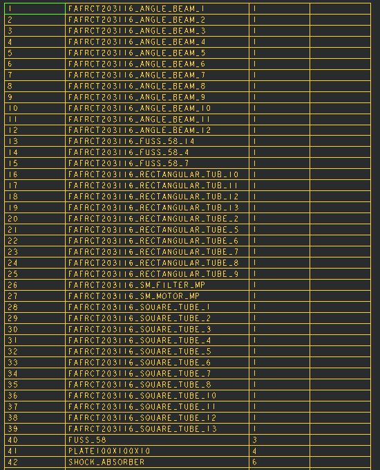

Table creation query
Please see the below screen short
When i created the table. Some of the rectangular tubes in same size. I want to segregate according to  the size. Please advice me.

    if you need to get several row blocks, then you probably need to define several repeat regions with specific filtering.
    Please provide more details.

    In the screen we have multiple square tubs but 1 to 5 square tubs are in same length(500mm). I want to make it single row with qty 5Nos. Please provide some examples.

    You need to control in the repeat region.
    Table --> Repeat region---> Attributes--> No Duplicates

    I'm assuming, because you didn't specify, that this is an assembly.
    If you have a bunch of parts that are defined with the same physical dimensions, why are you using multiple parts with different names? The "_1", "_2", etc. If you need a bunch of the same part repeated in different locations in the assembly, you just assemble the same part multiple times. I guess I just don't understand what you're trying to ask.
