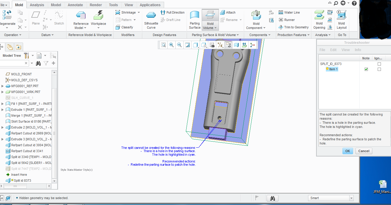

I am facing the below issue while splitting work piece in Creo parametric.
Can anyone help me to resolve this issue.
    Feb 20, 2015 12:38 PM UTC
    Could it be that the part is imported and there is an error like a bad vertex on the geometry at that spot?
    Feb 24, 2015 11:20 AM UTC
    I think the problem is just you have a hole directly inside your parting surface.
    When you look throught the hole you see background color (white) instead of parting surface color (blue).
    Try to fill it and it should work.
