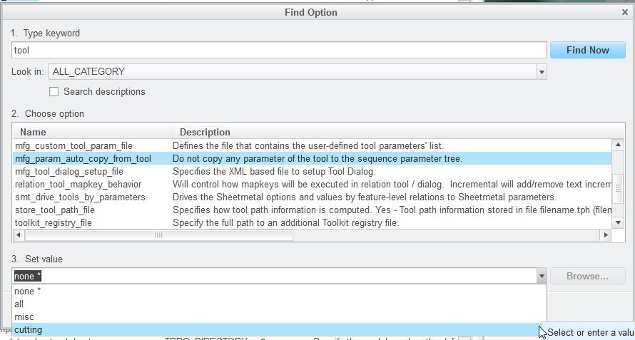

    Oct 6, 2014 4:42 PM UTC
    Maybe try to change this in your options setting,

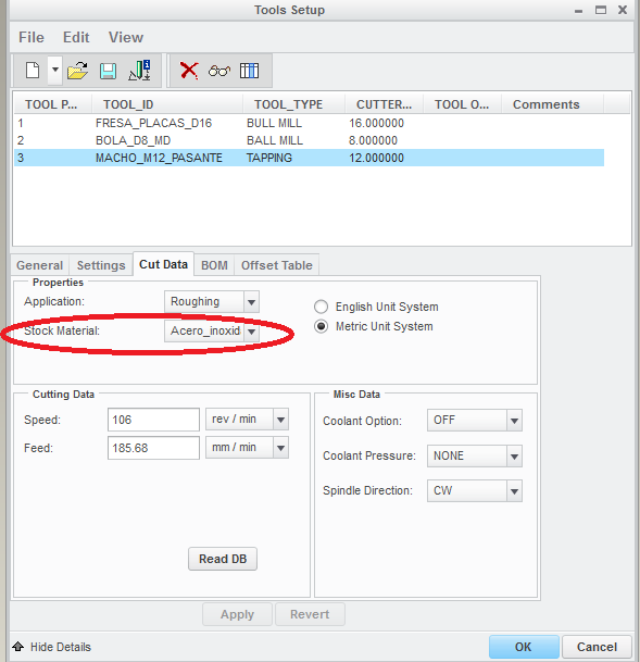

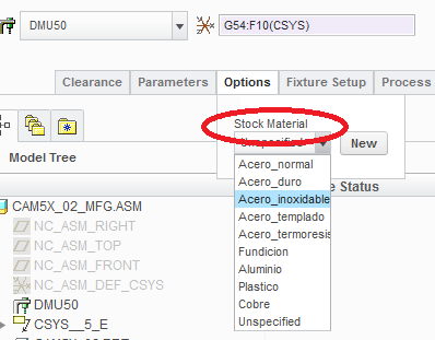

    Nov 5, 2014 11:35 AM UTC
    I suppose you know.., you can set tool conditions for different materials and then use them in your manufacturing model selecting the stock material:
