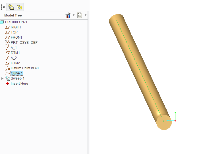

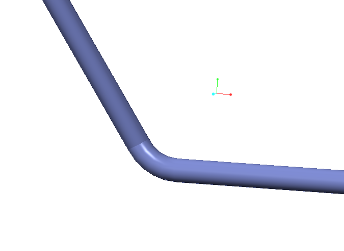

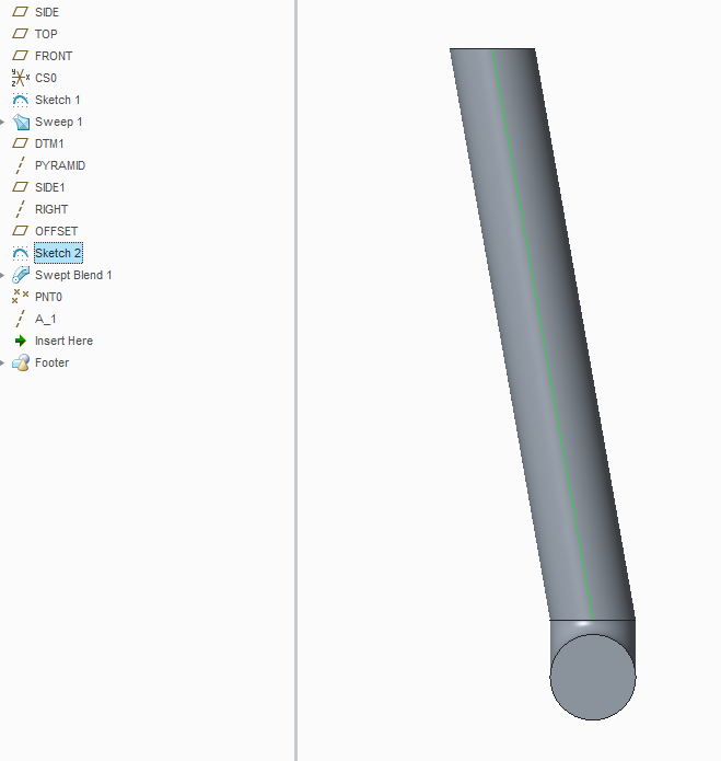

How do i model a tube (left arm only) in two trajectories in one pass?  i got the left arm rotated in one direction (see 1st pic) but i also need to be rotated in another direction like  in pic 2 which i dont have. I had to split it in two sketches. I am sure there is a better way to model this. Any tips?
1st pic:
2nd pic
this is what i am getting.

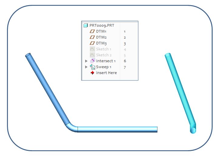

    If I understand you correctly, Joseph, this is not difficult. You just need a single trajectory that is not all in the same plane. You can get all kinds of complex shapes using compound 3D curves. Just sketch the 2D for the whole path from one perspective (don't agonize about the sketch plane). Then sketch the appropriate view on another plane at 90 degrees to the first. Cntrl select both sketches and select Edit/Intersect to get the compound trajectory.

    Is this what you wanted to do? Attached is the creo 2 file.

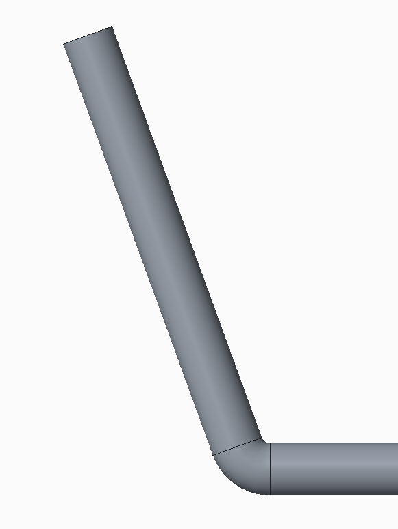

    what you are really trying to create is a simple single sweep, it is not two trajectories.  There are two ways to achieve this.  First is create your two dimensional sweep then add another datum plane to give you the twist angle see picture below.  I created the sweep trajectory on the front datum plane.  Swept the tube then I added DTM 1 through the axis of the tube on an angle to the front plane, I then made the drawing using DTM 1 as the top ref, and RIGHT as the right ref.
    Additionally you could do this by adding the angled datum plane first then put your sketch on that plane and sweep along it.  You would get the same results.

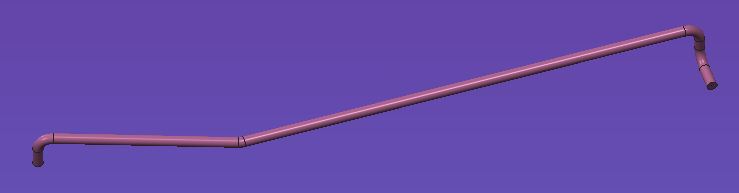

    Another way you can do this is establish both of your straight centerlines of the tube with curves.  Either simply sketched on planes or use the intersected method as shown by BH 001 above.  Once you have both of these curves completed you then want to make a curve through points.  Click on the two end points of the curves.  A straight line will form between the two points.  Next click the options tab before finishing the curve, select tangent for end controls and select the centerlines/curves to set your tangencies.   You will end up with something that looks like this.  You can also go in and tweak this curve by pulling on some control points to further shape this curve.

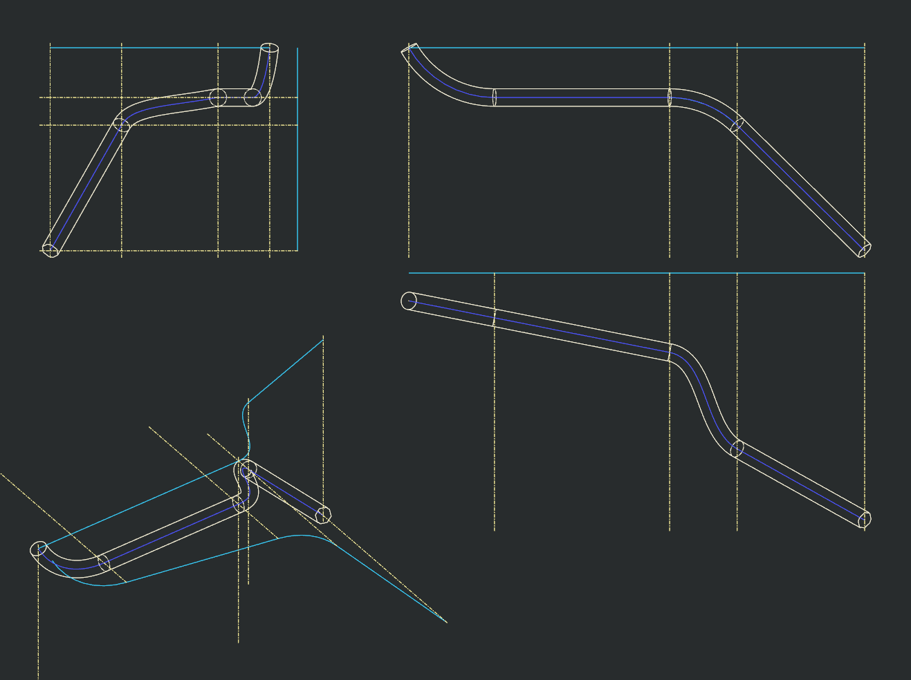

    Apr 4, 2017 9:21 PM UTC

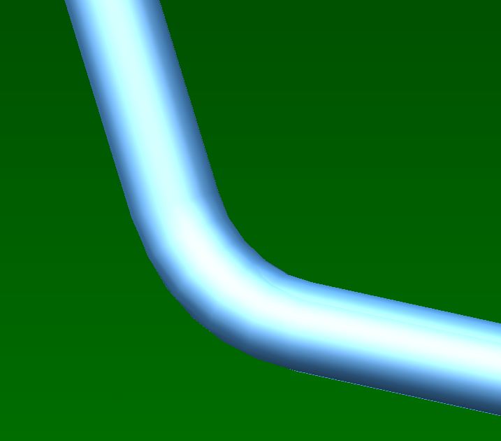

    If you are ok making multiple sketches and really want only a single sweep in the end, then all you have to do is shift-select the rest of the chain.  It does not have to be a chain created in a single sketch.
    Alternatively if you don't like weird kinks in your intersected curves, then you need to ensure that the end-points of the segment in question line up in the direction of projection.  however you should be aware that intersecting 2 arcs won't yield an arc.
    OR with some slight alterations - you can have this:

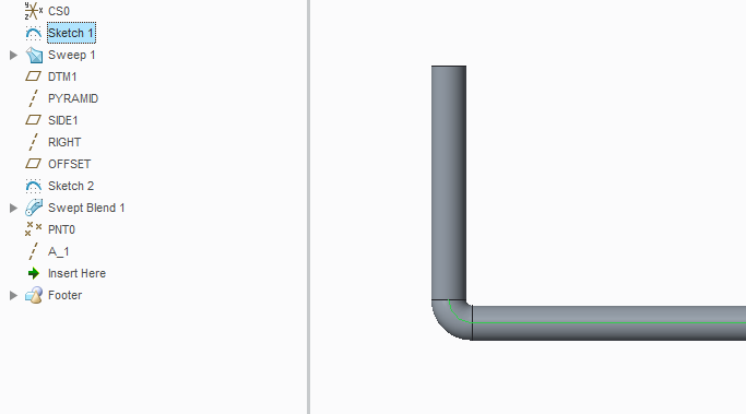

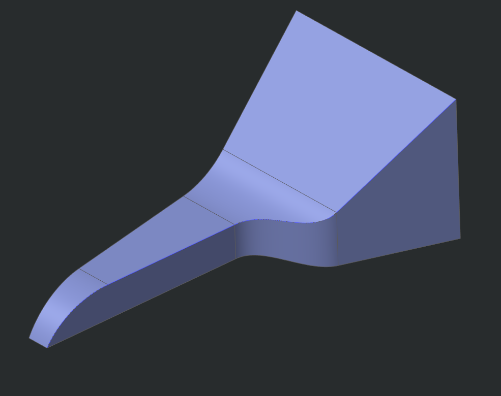

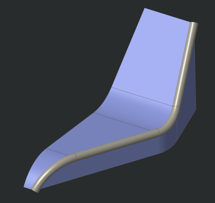

    Apr 6, 2017 4:33 PM UTC

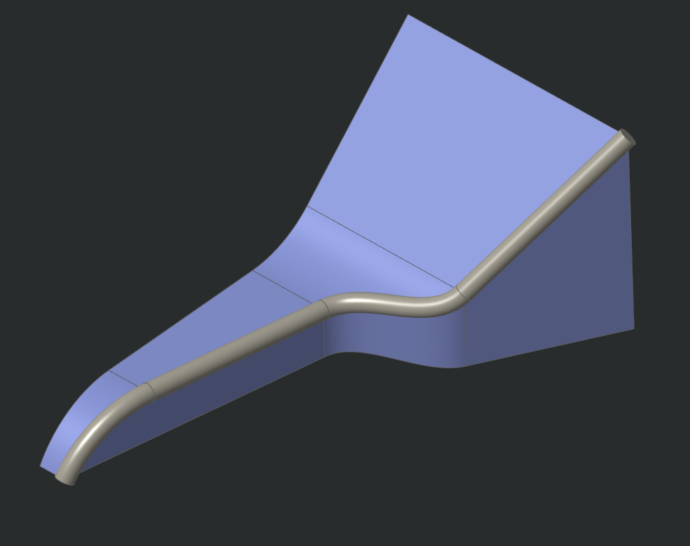

    Here is an example of how I have done something similar to what I think you are trying to do.
