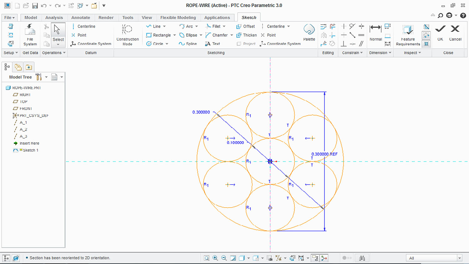

how can I make coaxial wire which are made of Central core wire with 5 outer wires (100-twists per inch) see the fig?

What diameter of wire do you want to use? Can it physically to do 100 twists per inch?
