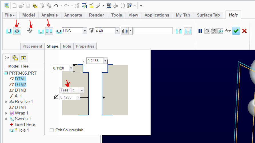

Is there anywhere to download some standard user defined features for common features like counter bores? I'm tired of looking up what size of a counter bore I need to make for different screw sizes.
Or should I be doing this with map keys?

    you could definatley do this using multiple hole files
    UNC_CB.hol for standard SHCAP screws
    UNC_CBL. hol for low SHACP screws
    etc
    In each files set the CB dimensions and associated note you want for each screw size.

    This should be handled in the standard hole files for clearance holes.
    I don't use them but that should be possible.
    Jun 23, 2014 7:42 PM UTC
    This would work for standard SHCS but I don't see any option for selecting a size for a low head cap screw or a button head.
