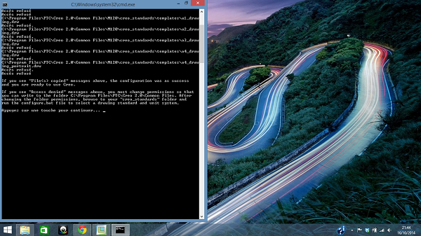

Hello !
I would like to change the unit measurement in "millimètre newton seconde".
The configure write "Acces denide" and I don't understand what I must do.
Can you help me please ?
Thank you !
P.S: I'm french
Oct 16, 2014 7:58 PM UTC
Unit conversion is done at the part/assembly level within Creo.
File>Prepare>Model Properties>Units - change
