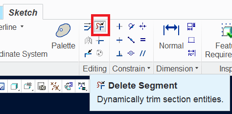

    Dec 3, 2015 8:31 AM UTC
    use command shown on picture to remove unwanted parts of intersected geometry circles.

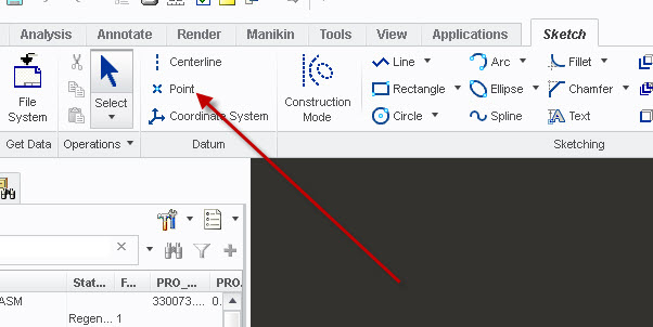

    StephenW
    Dec 3, 2015 4:17 PM UTC
    You can't use construction lines outside of the sketch, they are for construction of the sketch only.
    If you add a datum point within sketcher, it creates a point you can use as a reference  (or an axis if it's a sketch within an extrude.
