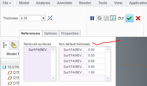

    Yes.
    You can use the Non default thickness option to select the specific surfaces with their own thickness:

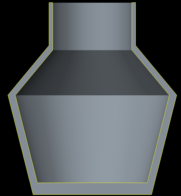

    But it creates a step in the model !
    Do you have any image for reference
    May 26, 2016 11:46 AM UTC
    No. It will not create steps.see attached.
