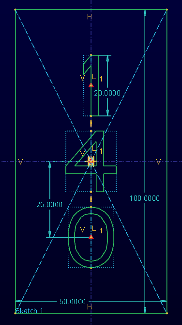

Hello , I am trying to do a vertical embossed font need help to make font aligned. no problems do horizontal font. I attached a sample what i like to do
any advice would be helpful

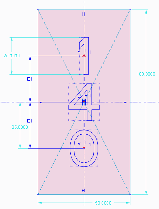

    This is simple enough; enter each number and change its properties in the section/sketch to center/middle and dimension it. You can align them vertically with constraints; maintain their height with equal lengths. Just dimension the vertical spacing or constrain them in some way.
