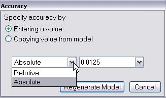

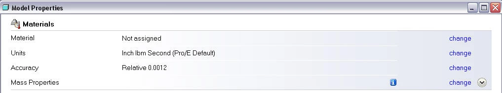

    No, Relative seems to be default, at least on Pre-Production. It is now listed in new GUI Model Properties. It's a bit strange. If I change a model that was created with Relative accuracy I can only change the value. However if I change a model created with Absolut accuracy I'm allowed to change to Relative. If I change from Absolute to Relative I'm also allowed to change back to Absolute. This gotta be a bug. See attached pics.
