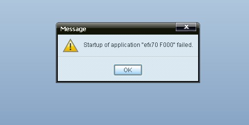

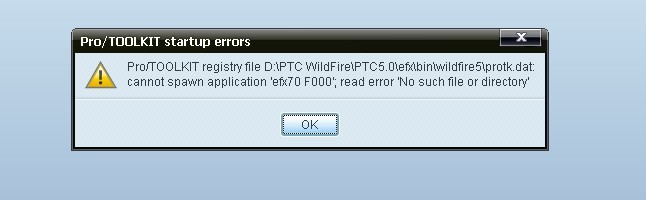

What kind of the causes that?
    Apr 6, 2011 8:39 AM UTC
    Rename file
    e:\ptc\ProeWildfire5\efx\x86e_win64\efx70_wf4.dll to
    e:\ptc\ProeWildfire5\efx\x86e_win64\efx60_wf4.dll
    Rename file
