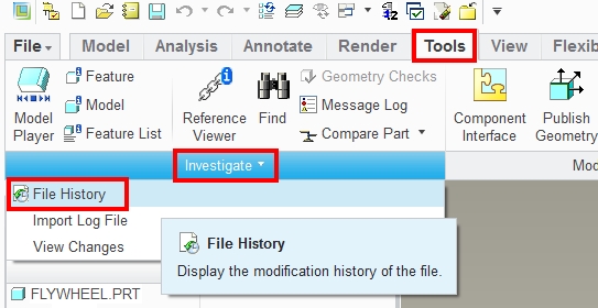

Where is the command "Audit Trail" at Creo 1.0?
There is a command at Proe 4.0 : Info ==> audit trail , it can generate the "Audit Trail Report", but at Creo 1.0, I can't find it .
    BariAnswer
    Aug 20, 2012 9:19 AM UTC
    I think that this is what you want?
    Go to TOOLS tab under Investigate group you have the option FILE HISTORY.
    Bari14-AlexandriteAnswer
    HAOWANG1-VisitorAuthor
    Aug 22, 2012 2:35 PM UTC
    Hi, thank you very much. This is correct what I seeking, and I think the "File history" is more proper than the "Audit Trail" ^_^
