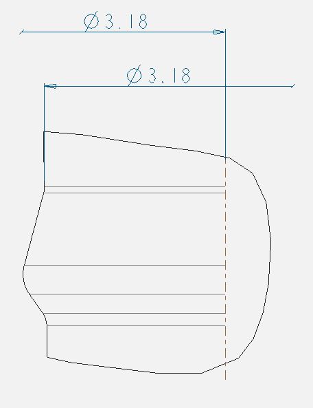

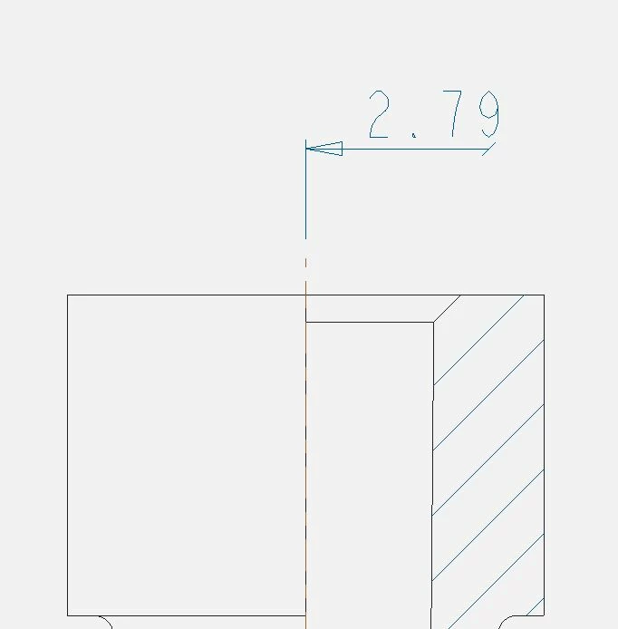

Why dimensions in half view are reversed?
See attached capscreen.
Thank you.

    gbenetti1-VisitorAuthor
    Dec 1, 2016 10:13 AM UTC
    Hello Stephen.
    When I create manually a quote I have to select two references but in half or broken view I have to select axis like a middle point of dimension.
    Then with right clic I select double value but the quote is not oriented correctly.
    In the immage you can see the wrong quote (upper) and the right quote (lower) obtained with Milan Bonka suggestion.
    In Wildfire release I haven't this trouble.
    Probably it's a wrong parameter in file config .dtl or .pro
    Thank you Stephen
