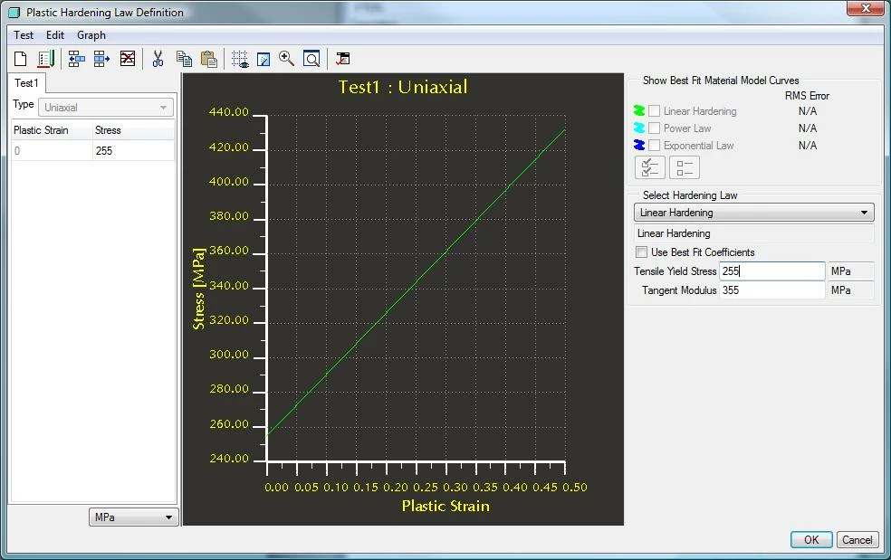

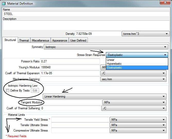

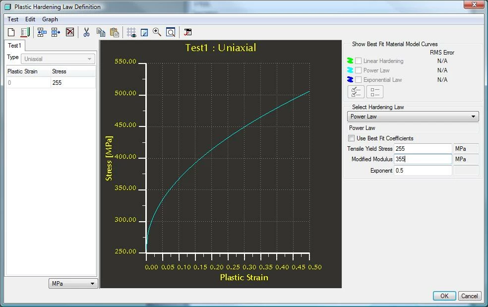

    the main point is the inclusion of small strain plastic model and a new type of constrain.
    have a look in the images.
    hope that helps.
