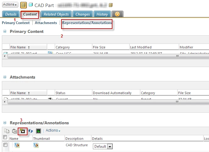

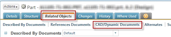

I have the need to be able to update the visualization for wtParts that are connected to EPMDocument. Use case is that I had a wtPart associated to the wrong EPMDocument. I unassociated and then associated to the correct one. However, I get a screen with a pyramid and I cannot get a viewable. How do I get a viewable to generate without opening up in CREO and checking it in?
I am on Windchill 10.1 m020.
wtPart Description page icon for viewable.

    Hi Vaibhav,
    Thank you for the information. What if the CAD Document already has a viewable? Do I just create another one, or do I delete this first? It would be nice that if there is already a viewable, that the wtPart would pick up on that.
