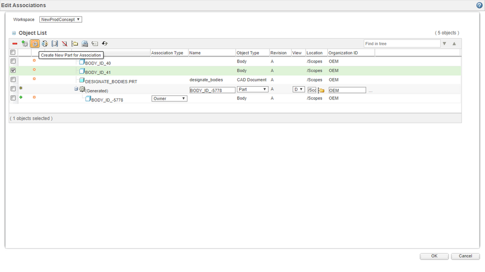

May 25, 2021 12:19 PM UTC
Once a Body has been designated in Creo and the Extension set to PRT and save and uploaded in the workspace, the Edit Association UI will show the Model Items created in Windchill representing these designated bodies.  From here you can associate the bodies to new or existing WTParts from Windchill.
May 25, 2021 1:30 PM UTC
It works fine. Thanks.
