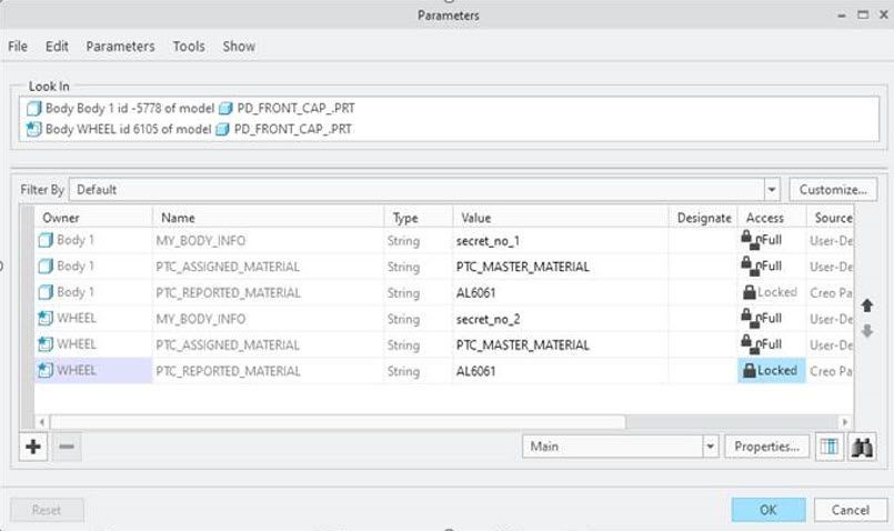

Let’s assume we have 2 bodies. Here their names and parameters list.

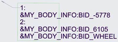

To call out the parameter “MY_BODY_INFO” for both bodies, we can now use the following for body 1
  • &MY_BODY_INFO:BID_-5778
And one of the following options for the WHEEL body (which has id 6105)
  • &MY_BODY_INFO:BID_6105
  • &MY_BODY_INFO:BID_WHEEL

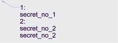

So if you create a note and enter:
You will see the resulting note text being:

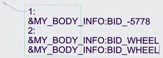

I think we have a preference of using body names. Therefore the system automatically tries to convert the body IDs to body names where possible.
So when you go back to the call-out symbol definition, you will see it being changed to
