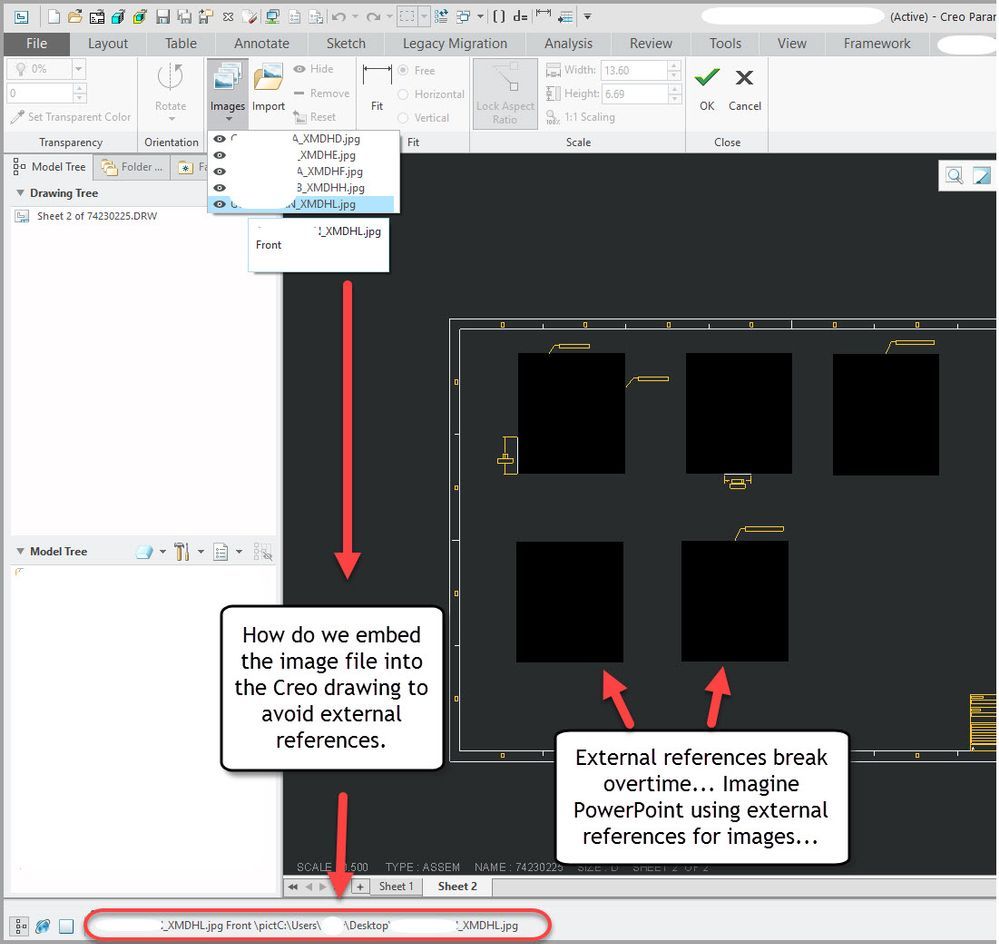

Jun 7, 2018 2:41 PM UTC
How does one embed images into a drawing so there's no external references or links? When we add an image to drawings, Creo 4 M040 creates a link to user's computer location for the image. The link breaks when the drawings gets checked into Windchill because the file isn't found on the next person's computer. If it is possible to embed images, is there a way to make it the default? I assume most people would want to have images embed by default... imagine PowerPoint having external links to any images. Everyone would have broken PowerPoints all the time.
Jun 7, 2018 2:57 PM UTC
I think I figured it out. The unintuitive setting save_texture_with_model yes seems to control this. Why this is defaulted to no? Seems like that is a recipe to break things all the time.
