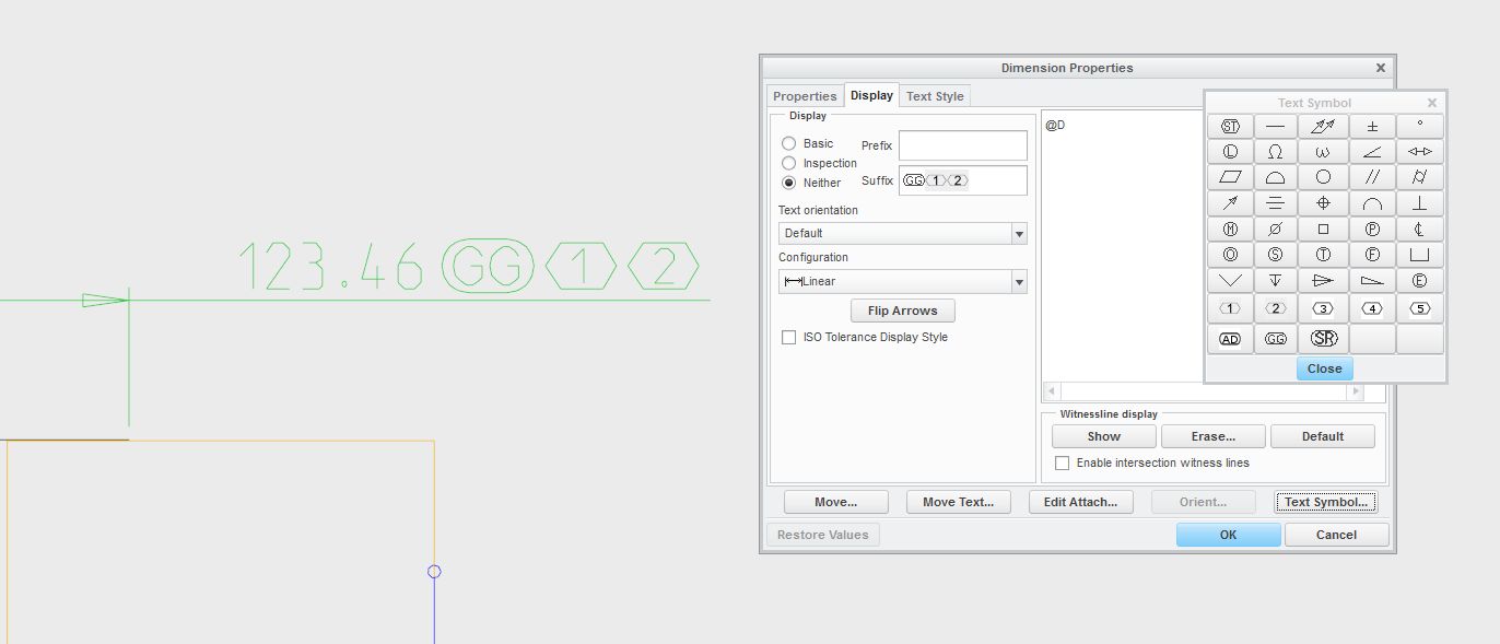

2. A new version of ISO 14405-1 is in the stage "International Standard under publication" and should be published until the end of 2016 according roadmap‌ of the TC213. I have access to the German DIN version in draft stage from 2014. In this edition in section 8, the eyecatcher symbol is defined and can be used as complementary indications on the drawing.
   10±0.1 <1>  -  10±0.2 <2>
   <1> prior to heat treatment
   <2> after heat treatment
The eyecatcher symbol is a honeycomb containing numbers. The additional text is typically placed nearby the drawing header.
Attached a screenshot of Creo 2.0 using our custom made textsymbols.:

At the moment it is too late to add these symbols to the symbol font for Creo 4.0, but I will add them to my list for Creo 5.0.
Do you only need numbers 1 through 5 or would there be additional numbers needed?

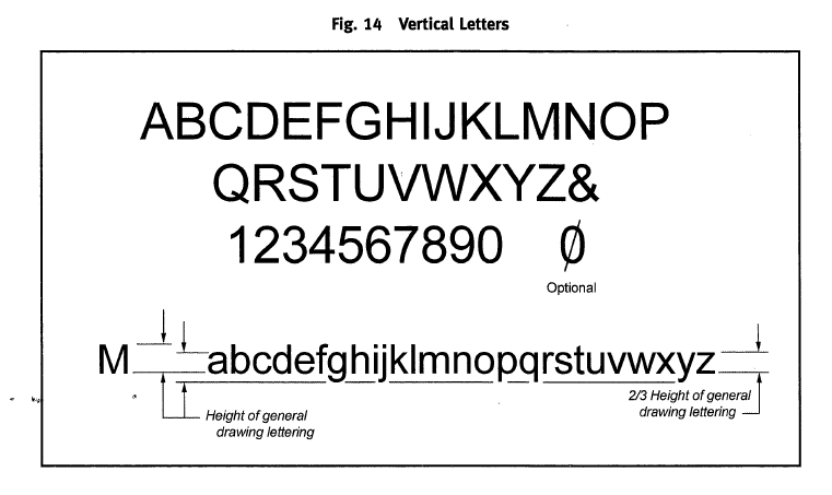

Thanks. Do you know which ASME standard approves Arial as a font to use? I'm glancing at hard copy of ASME Y14.5 - 2009 and all the examples seem to be in Arial but I don't see anything that says that it's Arial. Maybe ASME Y14.2 - Line Conventions and Letting? The reason I ask is that I had some engineer's ask if Arial was ASME approved and I didn't think the wiki page really counted.

Sad to hear that this is already to late for Creo 4.0. This means that we still have to use custom textsymbols? I'm worried that this no longer works, as it seems that the technical implementation to handle such symbols has changed in Creo 4.0.
Numbers 1 to 5 might be a bit tight. Currently we have drawings already using 1 to 4. According the norm the possible numbers are unlimited, practically 1 to 10 would be a good compromise.
Maybe this could be something which still coud be implemented in Creo 4.0: Create a "text in a honeycomb" using @<This is a text@> which is following the currently available "text in a box" @[This is a text@] feature.

It is ASME Y14.2 that covers the font and lettering requirements. They don't call out Arial by name - probably since the name of the font is determined by the specific creator of the font and this would effectively mean that they were requiring a specific commercial product. Instead they provide some requirements about the size and appearance of the font and let the users and CAD vendors choose the source of the font that matches the requirements. However, if you look at Fig 14 from the standard and compare it visually to a few sans serif True Type fonts, Arial matches the design almost exactly and seems to be the best fit among all of the fonts I reviewed. It's also nearly universally available on Windows computers (even though we're now providing a version with Creo).
Also worth noting that the ASME standard does not require visual distinction between the uppercase "i" (I) character and the lowercase "L" (l) character. The number "1" does have a small flag at the upper end, so at least it is distinct from either the "L" or the "i". If you're interested in some more discussion about the Arial font, check out this product idea: The Number "1"
