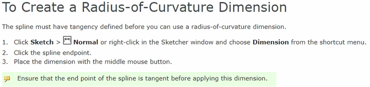

I believe the dimension on the end point of a spline actually controls the radius at the end of the spline.
kdirth
Mar 27, 2024 4:04 PM UTC
From Creo 7 help:
