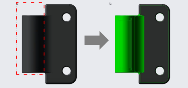

• 2D box selection in Creo also uses common direction-specific behavior.
o When you draw the box from left to right, all items entirely located within the box are selected.
o When you draw from right to left, all items touched by the 2D box are selected.
Drawing the box from right to left selects all items touched by the 2D box.
