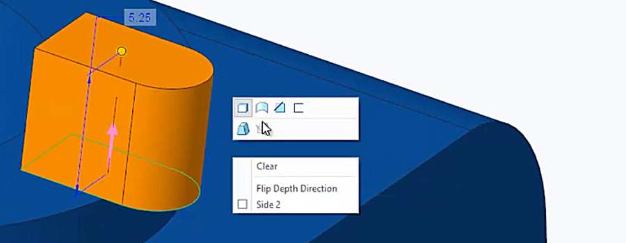

To Open  Feature Mini Toolbar in Creo
To reach a feature mini toolbar, simply click in the graphics area of your Creo screen.  A mini toolbar appears providing you with quick access to relevant options for your feature.
Right-click in the graphics area to open the mini toolbar AND a shortcut menu.
Image: Feature mini toolbar and shortcut menu
Note that in addition to the feature mini toolbar, there are also dimension toolbars that allow you to access some commands/options that were previously available only via the shortcut menu for the dimension.

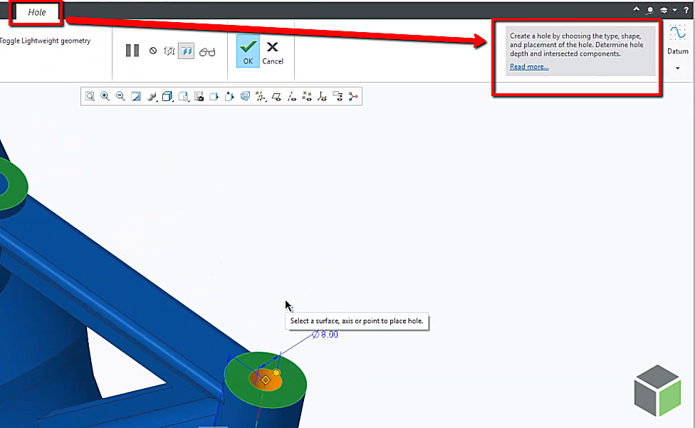

If you’re in a newer version of Creo, you’ll see that tabs have a new look. In Creo 6 and later, when you open a tab, a short description (plus a link to a Help page) appears directly in the UI.
Image: When the Hole tab is active, a short description appears in ribbon area.
