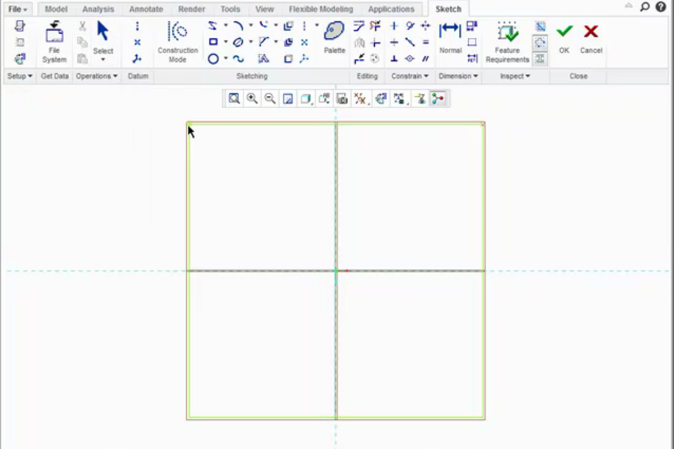

Step 1: Sketch a Square Section
You have two options when creating a blend; you can either sketch the sections ahead of time and select them in the blend tool, or you can sketch the sections within the tool as you create the blend. In this example, you will create external sections and select them in the Blend tool.
Begin by creating a square section on your first sketch plane with the Center Rectangle tool in Sketcher.

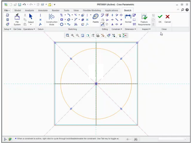

Step 2: Sketch a Circular Section and Divide it
Create a second sketch plane offset from the one on which you sketched your square section. Sketch a circle on this sketch plane using the same center that you used for your center rectangle.
Each section of the blend must have the same number of entities. You will tell PTC Creo how to blend the two sections together by splitting the circle into four segments to match the four segments of the square section.
First, orient the sketching plane parallel to the screen with the Sketch View button. You will see the square section and the circular section together. Next, select the References command and select the corners of the square section as references for the sketch. Then create two centerlines diagonally across the square through the corner references, and use the Divide tool to split the circle where it is intersected by the centerlines.
Divide the square and circle into an equal number of segments. This allows you to create the blend.

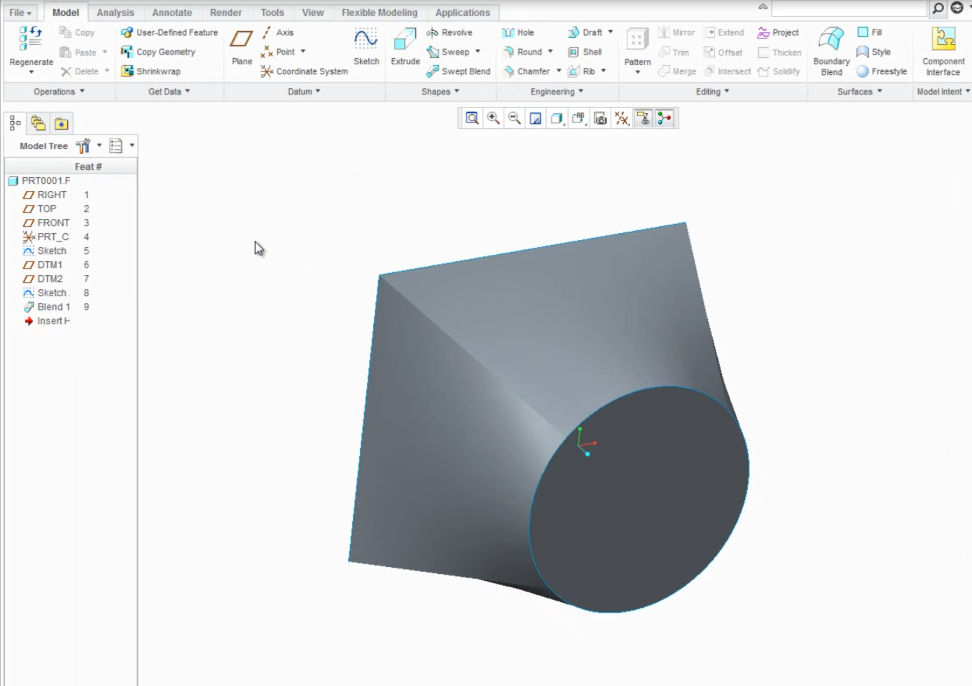

Create a blend with the Blend tool. Select “Selected Sections” under the Sections panel. Select the rectangular section as Section 1, then Insert, then the circular section as Section 2. If the blend is twisted, you can adjust the start point of either section by selecting the section in the collector and then dragging the vertex around the section. Here is an example of what the blend looks like:
The final product: A square to round blend
