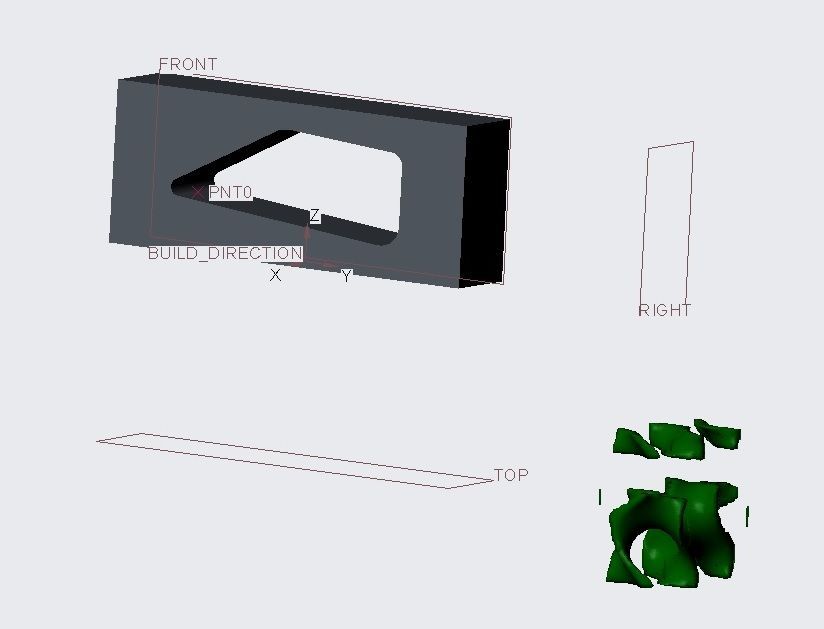

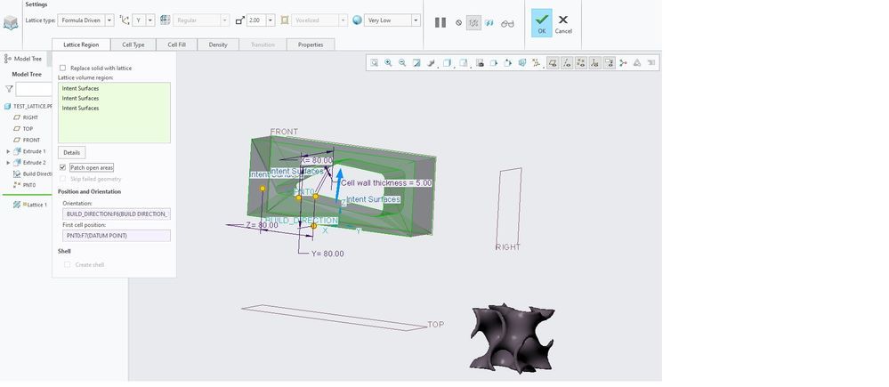

    November 1, 2019
    We currently try the new features from CREO 6.
    But we can't get a result.
    Before:
    imageAfter:
    Do you know why the lattice geometry just stays down there and gets flawed?
    Regards
    November 14, 2019
    It's possible the bounding surfaces have not been defined correctly. Please refer to https://www.ptc.com/en/support/article?n=CS253403 where it states "The Bounding Surfaces option requires a closed volume of references". Typically, if the bounding surfaces are not correct you'll get a warning "Failed to merge volume boundaries."
    It's not entirely clear from just the screenshot, but I would suggest adding the "front" and "back" surfaces to the bounding surfaces collector. If you've already done that or that does not work, please upload the model.
