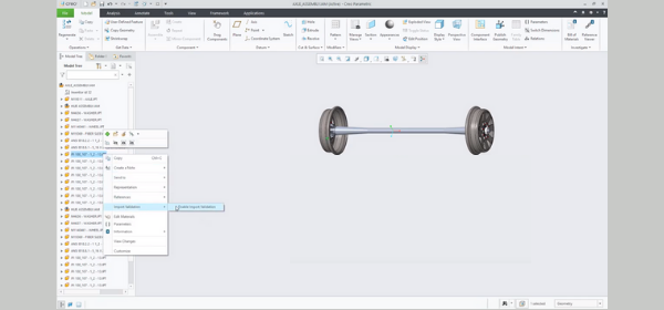

To Enable or Disable Validation for Individual Components
If you want to disable or enable import validation notifications for individual components, right-click the component in the Model Tree and select Import Validation.
 Image: Enabling import validation notifications for a component from the Model Tree
Note that when you select Enable Import Validation, it does not include import validation for models that have been imported or opened. And, it does not change the status for imported or opened models when they are modified.
