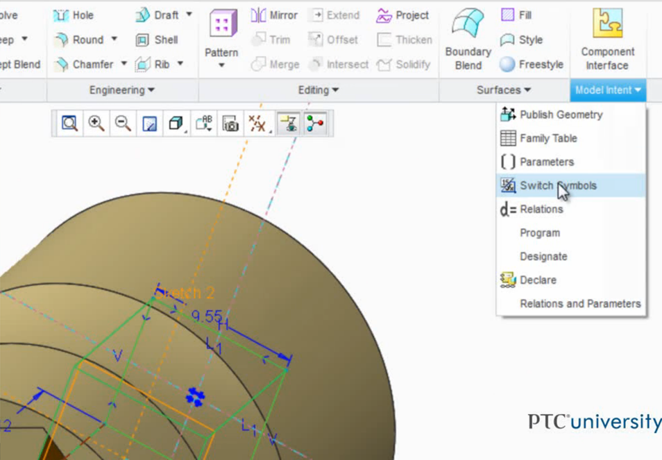

First, you must identify which dimensions or features will vary for your family of parts. Click on the Model Intent overflow menu and select Switch Symbols. This will show you the symbolic name of the features dimensions in your generic part (such as size or depth). From here, you will know which dimension will be altered in your family of parts.
DYK 6. Family Tables. Image 1.pngClick on the Switch Symbols command under the Model Intent drop down to understand the names of the dimensions in your part. This will help you identify what you need to change.

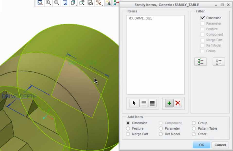

Go back into the Model Intent overflow and select Family Table. Click Add Columns in the family table dialog box. With Dimension selected in the Add Item section, click on a feature in the model, and then select the dimension you wish to add to the family table.
DYK 6. Family Tables. Image 2.pngFrom the Family table command, we can choose which parameters we want to alter in each of the instances we create.

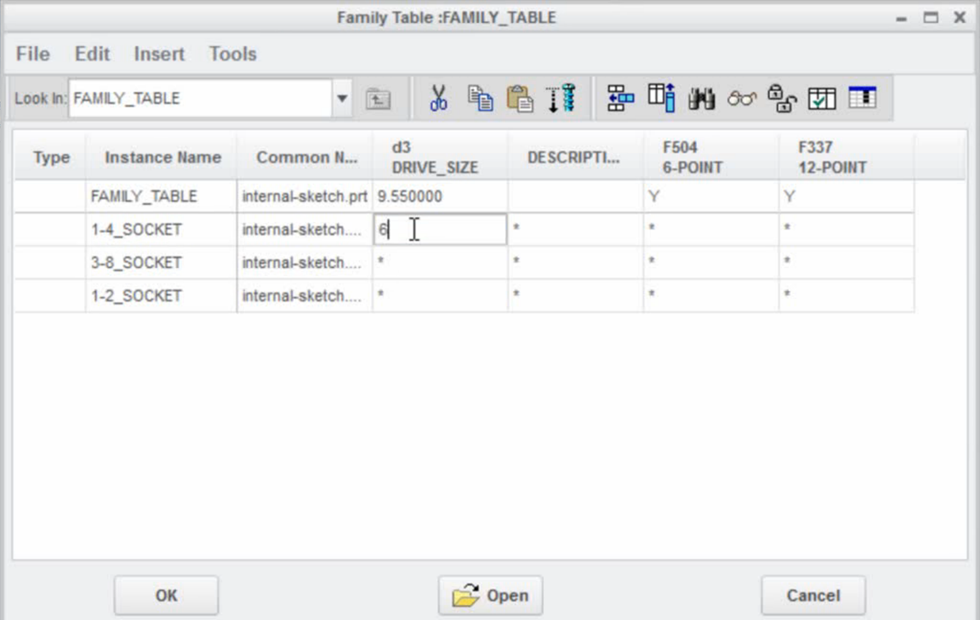

After choosing the parameters, we can chose the number of instances we want in our family table. Simply click Add Instances until you have the desired quantity.  You can edit the parameters for each specific instance. To finish the table, click Verify instances. This will tell you if your changes can be regenerated. Finally, you can preview or open each instance by selecting the appropriate row and picking Open. In the family table menu you can edit and verify the specifications on each instance you will create. You can also preview each part.
DYK 6. Family Tables. Image 3.pngIn the family table menu you can edit and verify the specifications on each instance you will create. You can also preview each part.
