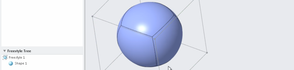

Select Freestyle from the ribbon and place a primitive on the screen. You'll notice a new Freestyle tree that includes Shape 1. As you add or create new shapes, they will each be represented in the Freestyle tree.
A new shape is added to the Freestyle tree.

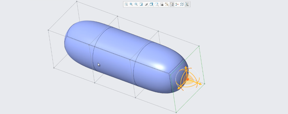

When you select a face you can now use a new shortcut ‘X’ to extrude the face. There are a number of out-of-the-box shortcut introduced in Creo 4.0  for most common capabilities within Freestyle.
Pulling the dragger extrudes the rounded face.

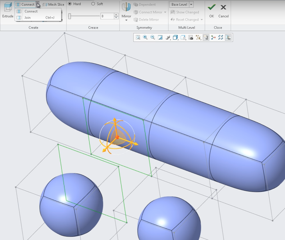

Several new editing tools are available to help you work with these multiple shapes, specifically around the idea of connecting shapes together or splitting them apart.
Connect allows two faces to be connected together by creating additional face patches in the control mesh, and Join merges those two faces together.
Using Connect to change the faces of two shapes.
You can also split shapes into multiple shapes. Select a face or four control mesh edge to define a face and then select Mesh Slice. The shape will be split into two shapes at that location and a new shape will be listed in the Freestyle tree.
If you drag the faces apart, you can work on them independent of one another; however, with the Connect tools you can rejoin them as needed.
