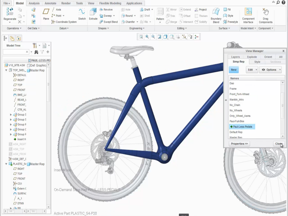

In this example, we will be working on a bike model and building the surfaces around the pedal. These surfaces are defined parametrically by the neighboring geometry. We will start with a sphere, and build out the geometry to get it close to the neighboring surfaces.
Building out geometry with Freestyle, it will be defined parametrically by the neighboring geometry

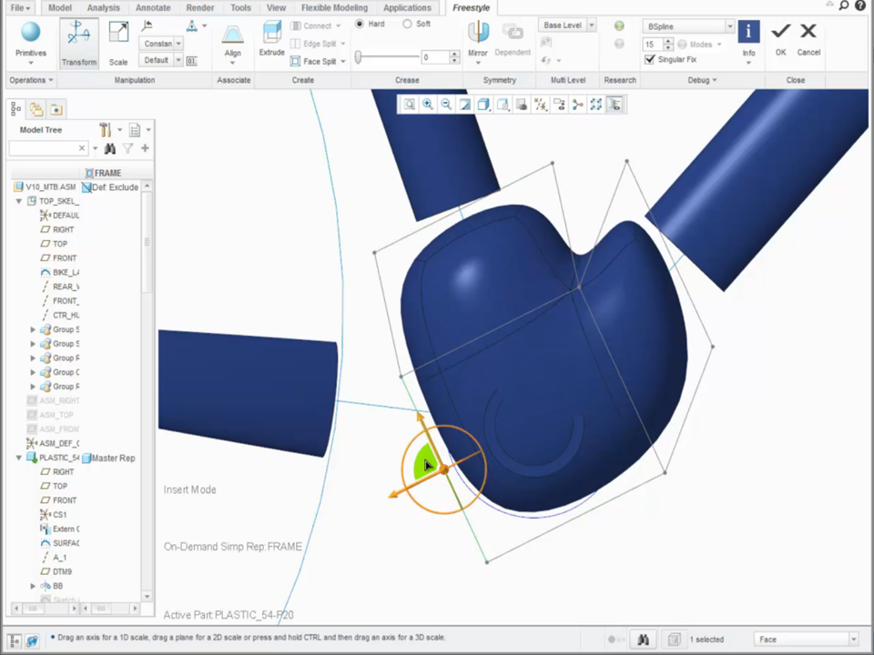

In this case, the part is symmetrical, so we are able to mirror it.
Next, you can select the faces you want to delete and leave open. You can then take the edges of the open loops and align them to the edges of the neighboring geometry.
Aligning the edges of the part to the neighboring geometry

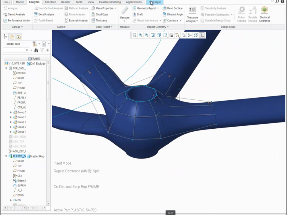

After the loops and edges are aligned, you can specify the continuity between the Freestyle geometry and the surrounding geometry. In this example, we will create a normal connection.

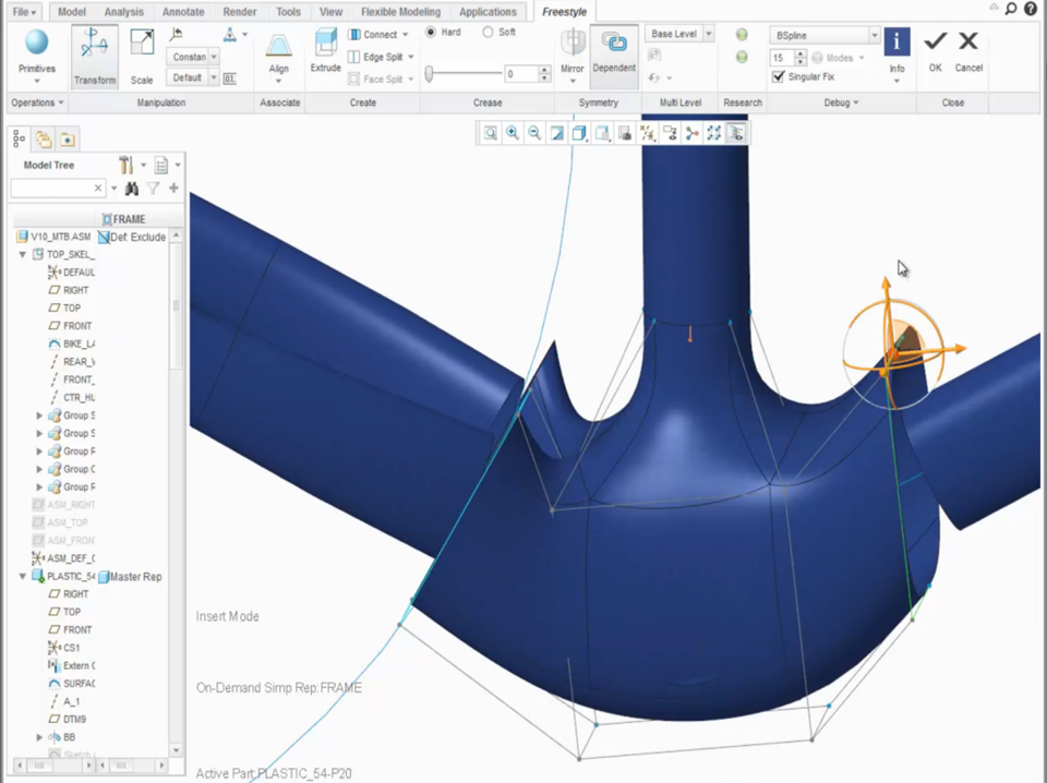

While we continue to refine the shape, we need to define the location for the pedals. Again, when the geometry is close, you can align the external edges of the geometry.
Here is a look at the completed geometry:
A look at the final geometry
Finally, you can return to the top level assembly and make changes to the skeleton model that is driving the shape of the frame. When regenerated, the Freestyle geometry is also updated to maintain the connection and tangency to the surrounding geometry.
Changes to the skeleton model will be automatically reflected in the Freestyle model during regeneration
