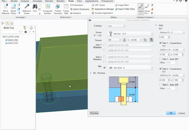

To define the position of a fastener, select the datum point, axis, or a hole. You can select two aligning surfaces to define a fastener connection with a thread. Or, you can select two opposing surfaces to define a fastener and nut connection.

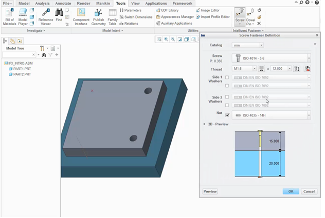

Next, select a fastener from the comprehensive library of fasteners. Choose the size of the thread or measure the thread size using an existing hole.
Selecting a fastener from the standard parts library

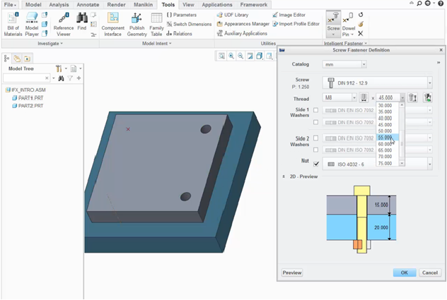

You have the option to set the length of the fastener yourself, or to have it set automatically. You can also control the hole tolerance and choose whether to have a counterbore on the top, the bottom, or both.
Setting the length of the fastener
There is a 2D preview in the dialog which updates with as you define the fastener details. Furthermore, you can click Preview to see a 3D view of the fastener in the graphics area.
You can get a 3D view of the fastener by selecting Preview
When you are satisfied, click OK to assemble the fastener.
After a fastener is assembled, you have the ability to reassemble or redefine it. Furthermore, if you reassemble an existing fastener onto a pattern, you will have the option to pattern the fastener. This saves significant time and effort.  If needed, you can choose to delete all patterned fasteners by simply selecting one and clicking Delete.
