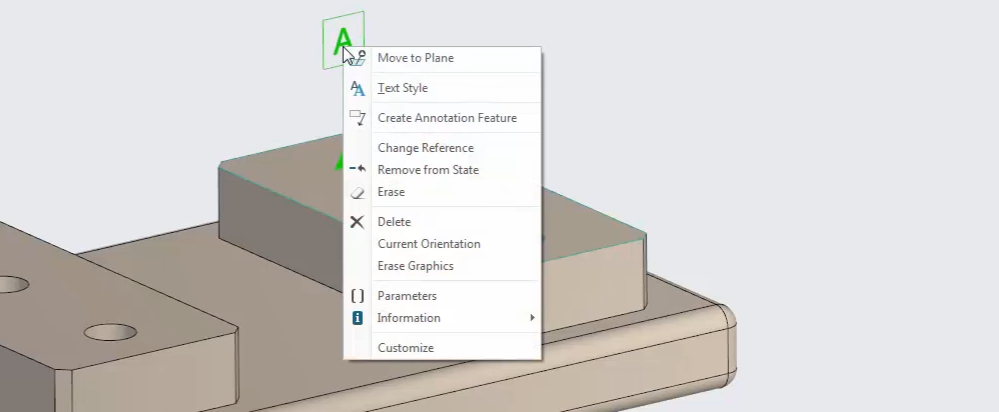

These features can have parameters, which you can access by right clicking on the annotation.
Right-clicking the datum feature symbol to access its parameters.

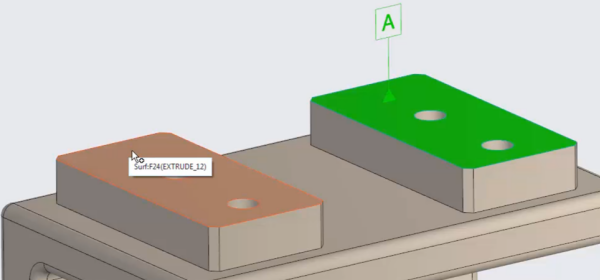

They can have multiple semantic references, which may be accessed from the References button in the ribbon.cover-image-trimmed.png
Adding a semantic reference to a stand-along datum feature symbol.

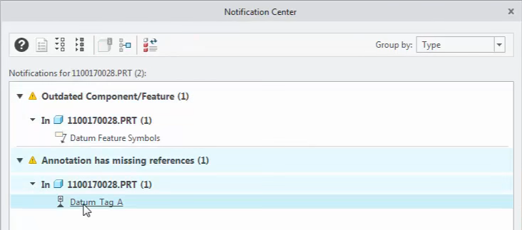

Look for notifications about problems with stand-alone datum feature symbols in the Notification Center. They are indicated with status icons in the model tree and detail tree.
If any of the annotation references are missing, they are indicated in the references dialog.
The Notifications Center reports a problem with a stand-alone datum feature symbol.
