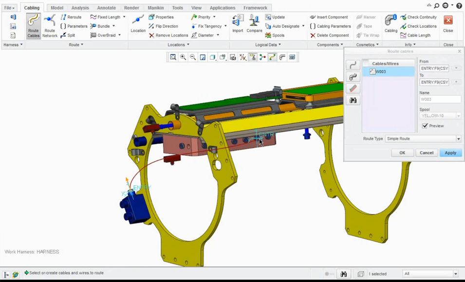

Tip 1: Filtering Logical Cables
First, select Route Cables under the Cabling section of the user interface. In the Route Cables dialog you will notice there is a Find tool. This will find all the wires and cables with logical references. If this is a very large list, you can refine it by simply selecting a designated component from the graphics area. When you select a designated component, the wires that attach to it are added to the Route Cables dialog. If you hold control and left click, you can select multiple components

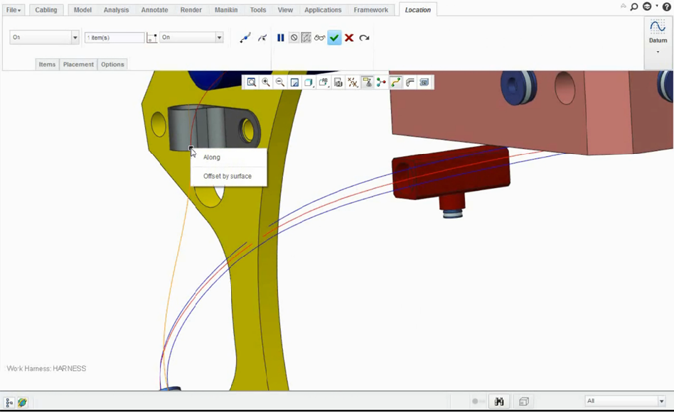

Tip 2: Adding Locations to an Axis
After you place your simple route, you can start adding locations. In Pro/ENGINEER Wildfire 4.0, the system would automatically place a location onto each end of the axis. If the axis was very short, the cable would form loops in order to satisfy the minimum bend radius.
In PTC Creo, the default behavior is to add a location on the axis at the selection point. If you want the old Pro/ENGINEER Wildfire 4.0 behavior you can right click and choose  Along or you can change the configuration option default_cable_axis_location  from On to Along and the system will then place a location at each end of the axis. Note: The configuration option is from PTC Creo 2.0 M090 onwards.
When adding locations to an axis, you can revert back to the old Pro/ENGINEER Wildfire 4.0 behavior by right clicking and selecting Along. This places locations at each end of the axis.

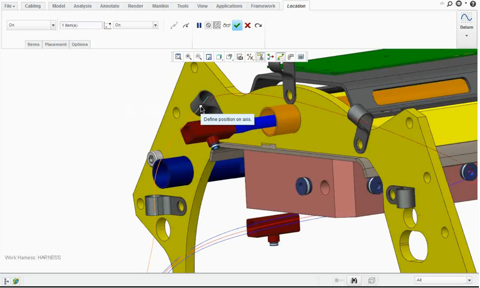

Tip 3: Choosing Next Locations
When you’re adding locations, take notice that half of the wire is orange while the other half is red. The red segments are where you’re going to add your next location. When you choose the next location and click, you’ll see that it has been added in the red segment.  If you want to add a location in the orange segment then simply choose Reverse Direction from Location tab.
DYK Cabling. Img 3.pngWhen choosing your next location, follow the red segments. When you choose the next location and click, it will be added to the red segment.
