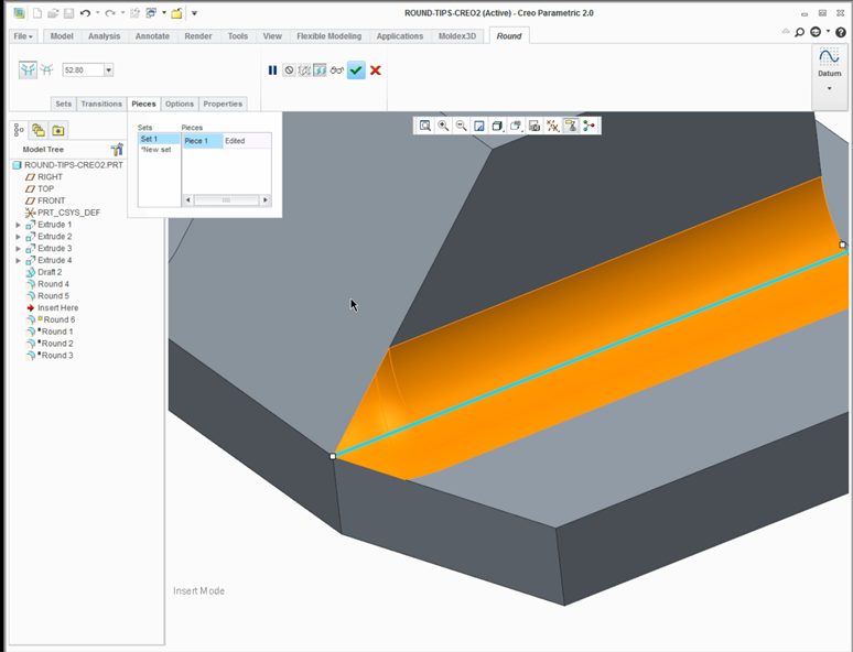

Putting a Round on 3 Edges – You can control the specific geometry at the transition of 3 edges.  Go to the main dashboard and click on the “Pieces” menu. From here you can hover over each individual piece and the software will highlight the geometry created. You can “include” or “exclude” specific pieces to control the overall geometry. See Image 1 below:
Image 1: Rounds on 3 edges

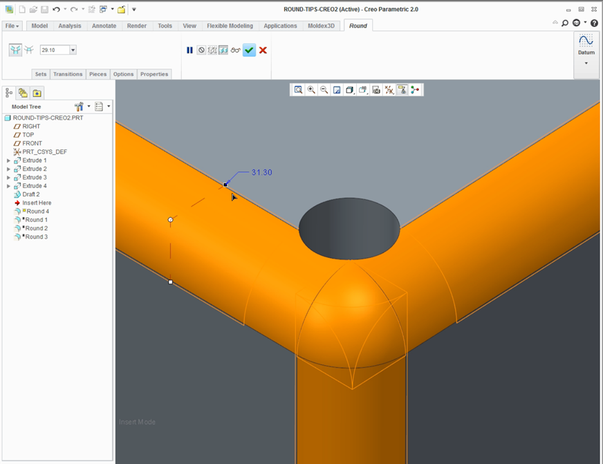

Creating a Blended Transition Between two different rounds – By default, when you select an edge it automatically rounds the tangent chain. By holding shift, you can create a round on just one specific edge. The transition between each edge is automatically blended. See Image 2 below:
Image 2: Blended transition

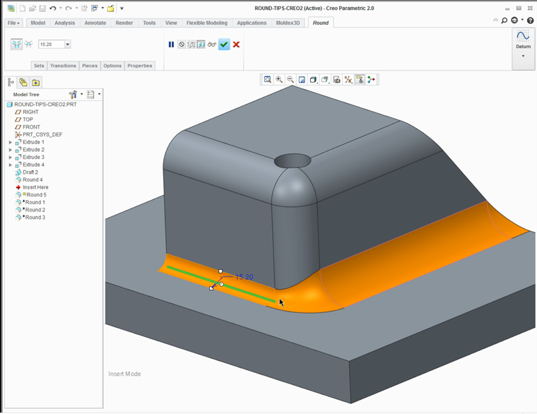

How to Make a Round Disappear - You can make rounds disappear into a single vertex. Go back to the “Pieces” menu and click on the single piece. This will create a drag handle. By selecting the drag handle and moving it down, you will cause it to automatically snap into the next transition. This allows you the ability to create surface-to-surface rounds, edge-to-surface rounds, or edge-to-edge rounds. See Image 3 below:
          Image 3: Rounds disappear
