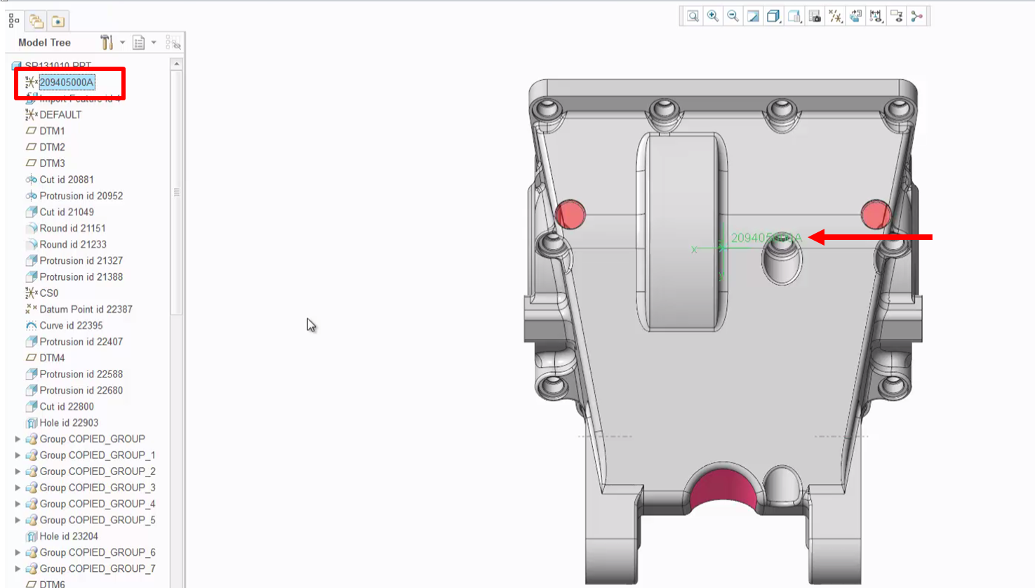

To orient the model in Sketch, first, look for datum planes that are normal to the chosen plane or surface as potential horizontal or vertical references. If you cannot find suitable datum planes, pick the default coordinate system for the part by clicking it in the Model Tree. This displays the section reference on the model.
Image: Within Sketch, the model coordinate system may be used as the section orientation reference.

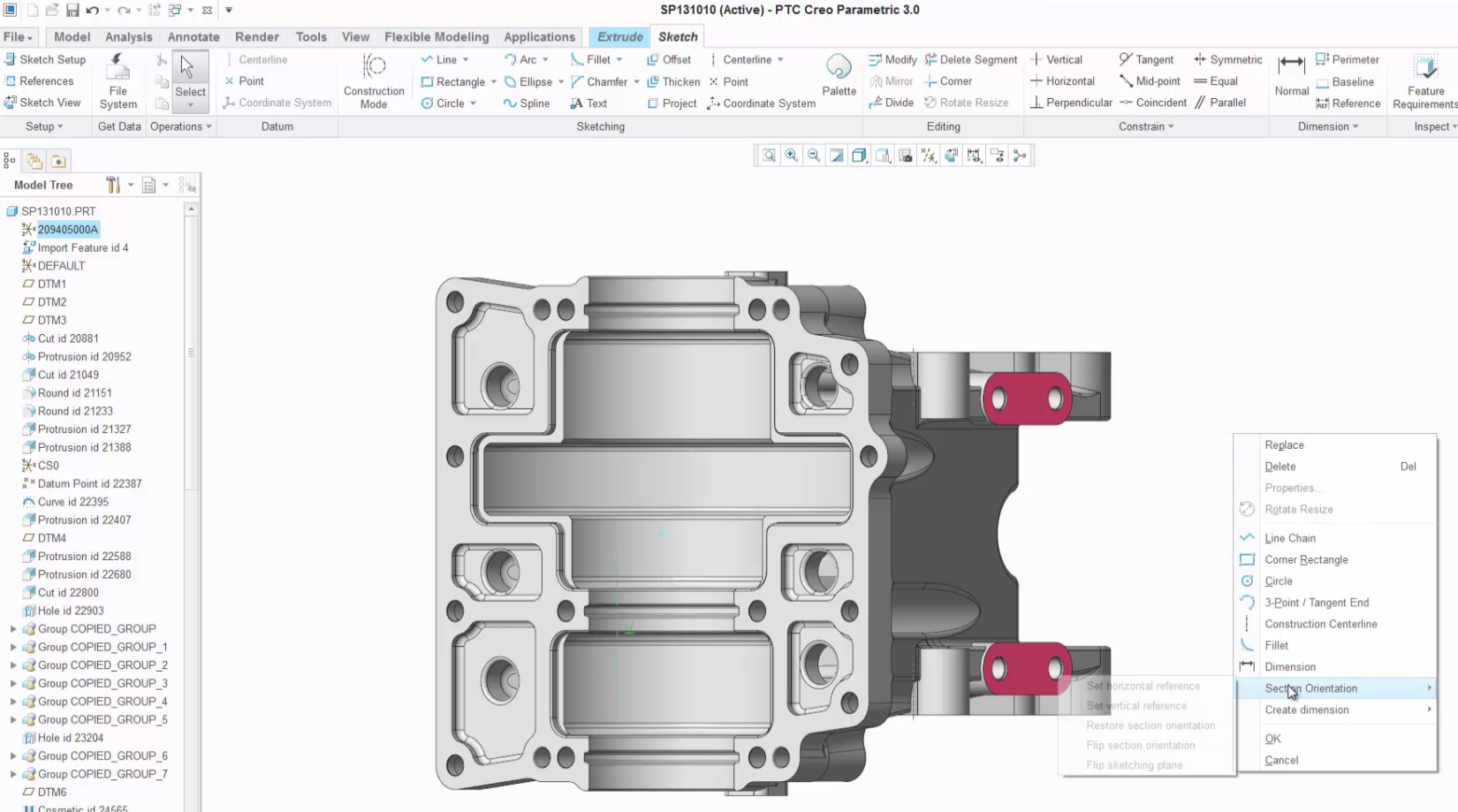

Once you are in the sketching environment, you may or may not like the model’s orientation. It is very easy to change. In PTC Creo 2.0 or 3.0, you can pick background geometry by selecting the Alt key. To change the model’s orientation, press the Alt key, right-click the desired reference edge, and click Add Reference. With the reference highlighted, right-click and select Section Orientation and then select a new orientation.
Image: To change the model’s orientation, press the Alt key, right-click the desired reference edge, and click Add Reference. With the reference highlighted, right-click and select Section Orientation and then select a new orientation.

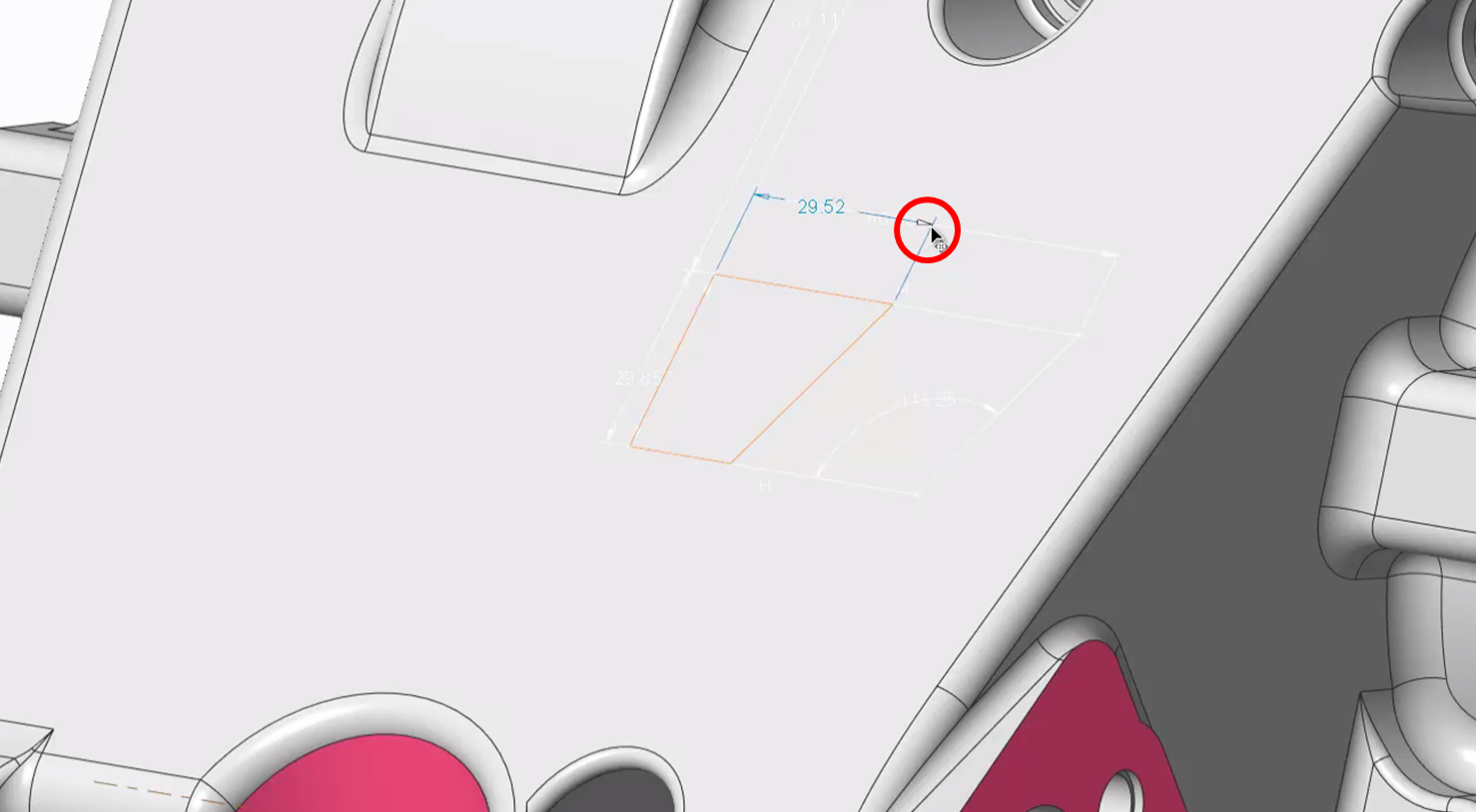

When you drag elements of a given sketch, multiple dimensions change automatically. This allows you to make changes to the sketch really quickly; however, in dragging elements of the sketch, you often don’t get the dimensions exactly how you want them. You can change the sketch with more precision using dimension draggers, which are the open triangles at the end of a dimension, as shown below.
Image: A dimension dragger is shown within the red circle.
When you click a dimension dragger and move your cursor, only that specific dimension changes; the other dimensions remain locked.

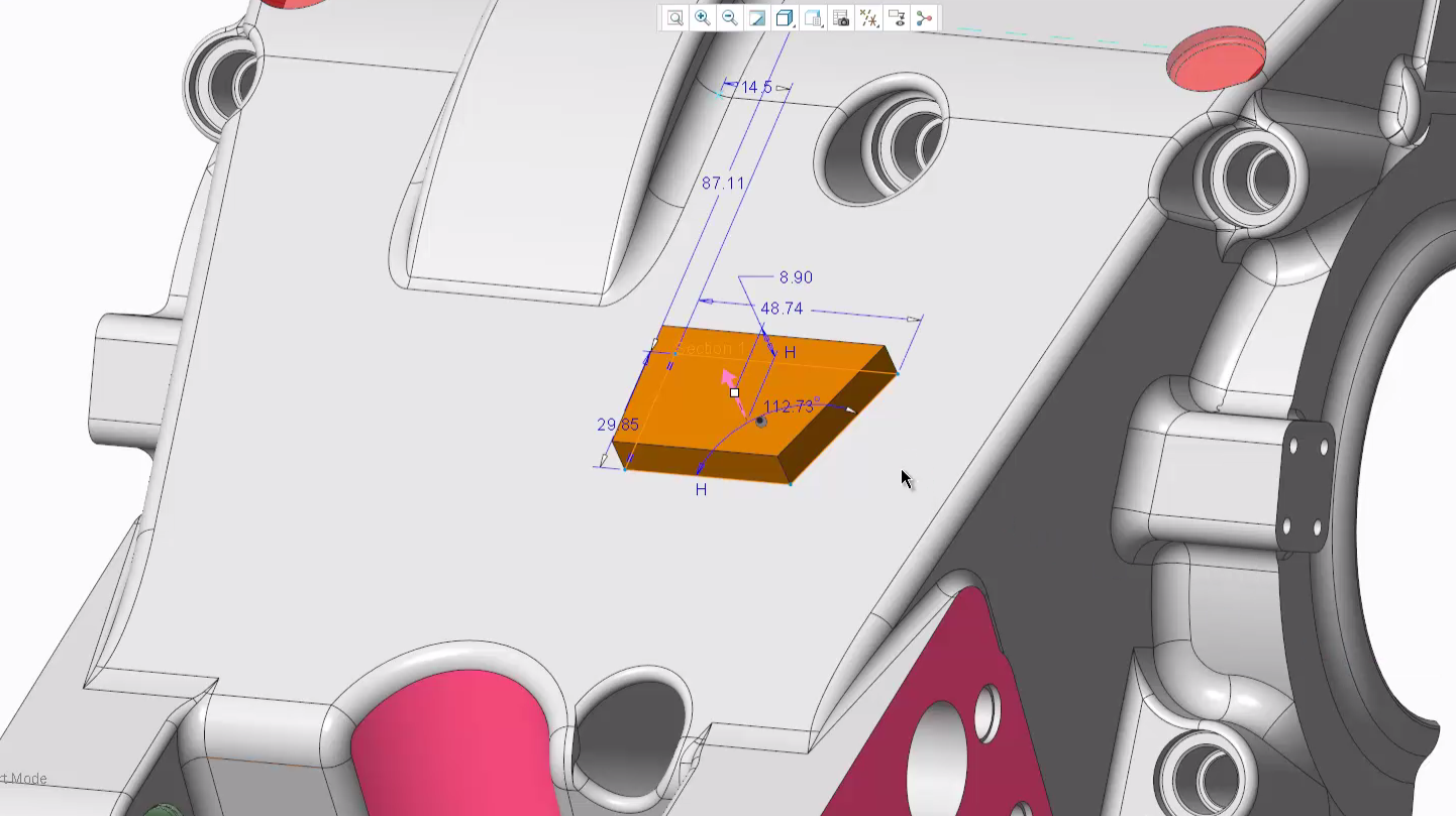

Dimension draggers are not only available in Sketch, they’re also available in feature preview. After you have drawn a sketch, click OK to save the section and exit. On the feature preview, right-click and select Show Section Dimensions. The feature’s dimensions appear, as shown below.
Image: Within the feature preview, right-click and select Show Section Dimensions to view all of the sketch’s dimensions.
In Feature Preview mode, to change the feature’s dimensions, double-click a dimension to type a new value, click a point on the feature and drag it, or select a dimension dragger and move your mouse to change that isolated dimension just like when you’re in Sketch.
