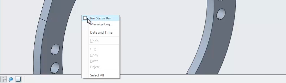

To keep the status bar with the message area visible permanently, check the Pin Status Bar option.
Image: Pin the status bar to keep it visible.

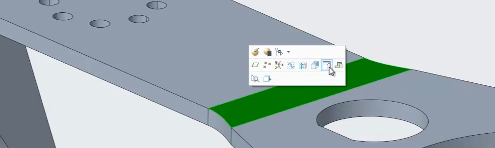

In conjunction with a new selection and mini toolbar, you can perform your daily tasks with ease.
Image: The mini toolbar opens when you make a selection.

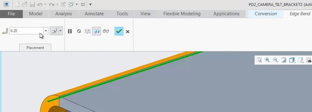

To reach the hidden areas, simply move the pointer to the location where they usually appear, and the ribbon, model tree, or message area automatically reappear.
Image: The ribbon is visible when you move your mouse to the top of the window.

    May 1, 2018
    I'm unable to pin the status bar. The only options that are highlighted are 'message log, date and time, and select all. Any suggestions?
    Thanks in advance,
    Creed
    May 2, 2018
    Status bar was hidden under Windows task bar. Changed Windows setting to 'hide task bar in desk top mode'
    and this allowed the task and status bar to toggle back and forth.
