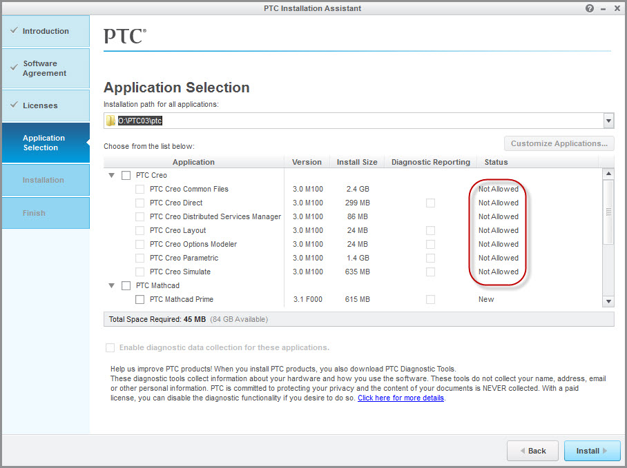

October 19, 2016
Thanks for the video
Its shows how to install locally, but how do you install on a mapped drive?
October 19, 2016
I have same problem with network installation, as I create locally installation first, copy-paste the
installation to my network disc and edit *.bat and *.psf files manually.
Regards
October 19, 2016
Yes, I know this Work around
But I think it is quit annoying, because we have a lot of different licenses and different startup configurations so it takes a lot of time and possibilities of errors.
I'm sure there must be quit a lot Companies with the same problem, so an easier installation approach would be very much appreciated
Regards Peter
October 19, 2016
O.K.
Other way, you can create the installation from computer that doesn't has local installation of Creo 3.0.
Regards
Leonid
