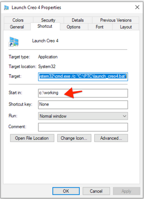

You can set the working directory on startup of the application.  But that is typically done in the shortcut you create to the actual creo startup.  My example is like this:
Alternatively, you can create a custom batch file for the startup of Creo (most do), and set your working directory as the start location also.   You could set an env variable in that if you needed it for something else... but typically those are only local to the batch file's execution as I recall.
