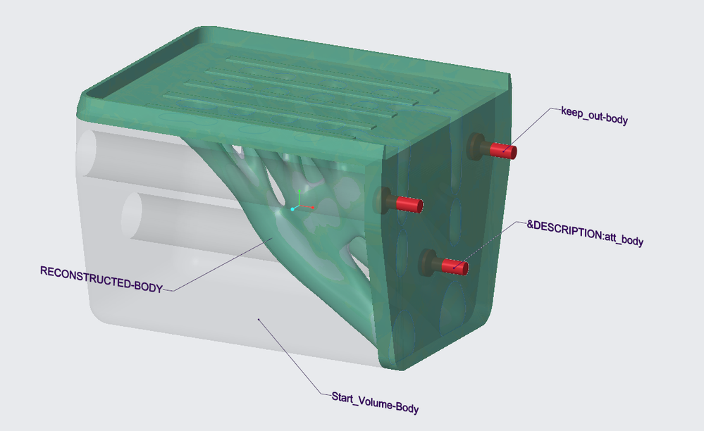

An analogue workflow is now supported for body parameters. We implemented and added this to Creo 8.0. This enhancement allows you to call out the values of body parameters into a leader note that is attached to that body.
To call out the value of a specific body parameter, you need to use the following syntax inside the leader note that is attached to that body:
&<body-parameter-name>:att_body
For example, if you have a body parameter called Description, you could create a leader note with the callout &Description:att_body  or call out the body’s material using &PTC_ASSIGNED_MATERIAL:att_body
When you create a leader note with this syntax, Creo Parametric checks the body to which the note leader is attached. If the called parameter exists for that body, then the body parameter gets evaluated and the parameter value is shown in the note.
In the case of an assembly, Creo Parametric looks for the called parameter in the body of the component to which the note is attached.
The callout is supported for all the environments and modes that already support :att_mdl.
Example:
All bodies have a DESCRIPTION parameter called out using &Description:att_body

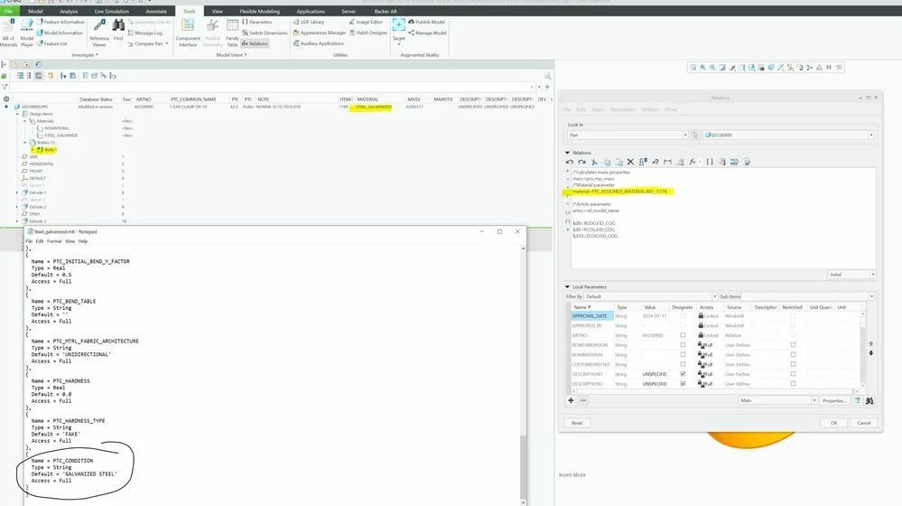

Mar 7, 2024 2:18 PM UTC
I have the same problem as @mstols mentioned.
If you could help @mneumueller  this would greatly help.
I'd like a startpart ready for single/multibody. Building on the old startpart logic, i'd like to be able to pull material names in with a "clean" description.
for 1 body i'd like the resulting string in the value field to be
GALVANIZED STEEL (not galvanized_steel)
for a multibody i think I need to work with table repeat regions instead, to look something like this:
 (User defined body name)(PTC_CONDITION)(... any material file parameter)
layer 1 Cool green material...
layer 2Super blue material...
Mar 7, 2024 3:40 PM UTC
Unfortunately that is not that straight-forward as there is no relation support within bodies.
Otherwise you could have just created a body relation to call  the above function.
So, currently not really supported.
But: If you know upfront how many bodies you need and create them as empty bodies in the start part (so you have their Body IDs) you could of course create part-level relations
MATERIAL_1=material_param("PTC_MATERIAL_DESCRIPTION",PTC_ASSIGNED_MATERIAL:BID_-5778)
MATERIAL_2=material_param("PTC_MATERIAL_DESCRIPTION",PTC_ASSIGNED_MATERIAL:BID_xxxx)
and then assign a parameter to each body holding
body 1:   MY_MATERIAL = MATERIAL_1
body 2: MY_MATERIAL = MATERIAL_2
and then call out the body parameter &MY_MATERIAL:BID_xxxx
But yes, this is limited to situations where you create the required bodies as empty bodies upfront in your start part.
