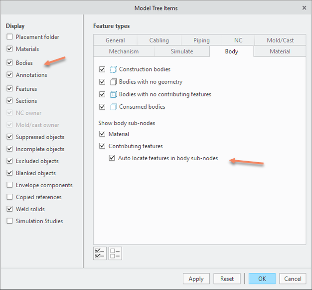

#1)  Creo 7.0:  With the introduction of Multi-body in Creo 7.0, we introduced the Design Items folder that optionally allowed to list the bodies in the model along with their contributing features. This led to additional feature nodes showing up in the tree. ( Note: The display can be configured within the model tree filter settings)
For Creo 7.0, the following options were available to control the body and body features display:
Note that the option “Auto locate features in body sub-nodes” allowed to control whether a feature node should be located in the feature tree as it worked in the past or whether it should be auto-located underneath the body that it contributes geometry to (e.g. locating the feature node within the contributing features list of/underneath a body)

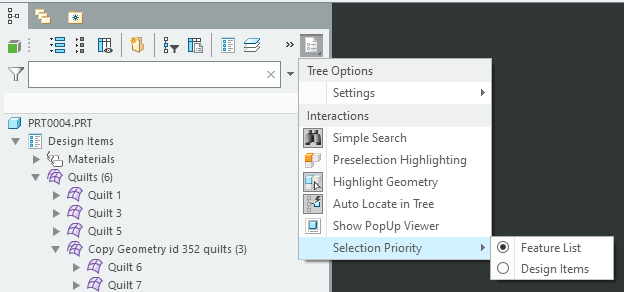

#2) In Creo 8.0 we added more options, added the display of quilts and their contributing features in the Design Items Folder, and moved the auto-location option to a new place. It now resides together with all the other auto-locate and highlighting related tree options.

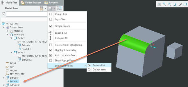

To control the auto-locate behavior, you now need to go to the “Selection Priority” setting under the tree options and set it to “Feature List” or “Design Items”. As you can see in the screen shot, the round surface  selection in the graphics triggers an auto-location to the feature node in the regular feature tree list and not within the Design Items as the setting is set to "Feature List".

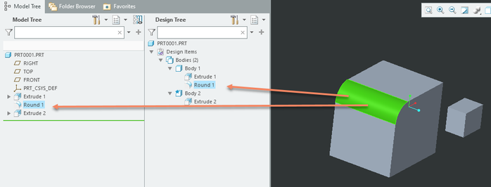

But there is additional flexibility: In a configuration where both trees are shown, you can now actually achieve a simultaneous auto-locate in the feature tree and Design Items tree side-by-side.
