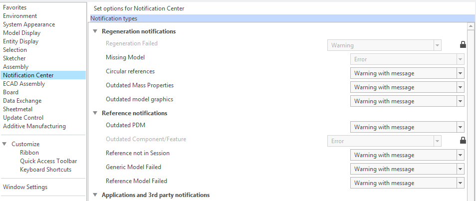

By adding the new options into the config.sup you can lock the  chosen severity level.
The below image shows the result of adding the following two items to the config.sup:
  • nmgr_failed warning
  • nmgr_reference_changed error

Any one knows how to lock any option in config.sup file. I have multiple options which i needs to lock in config.sup
thanks and regards
Nimish
StephenW
January 17, 2020
If you add an option to the config.sup, it "locks" it for the creo session that is loaded. A user can not change that option in the config.pro or in the options dialog boxes.
Be careful about adding too much to the config.sup
